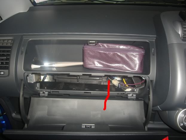

best place to route the cable would be accross the dash into your glovebox. You can take out the surrounding of the bottom half (this is also how you change your cabin filter) and there is a hole in that surrounding. Route your AUX/ USB in there.
Attachment 28508
