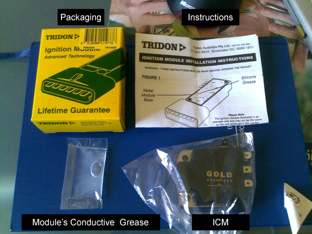

See pics of the new ICM below
Brand: Tridon - made in Australia
Type: Ignition Module - Lifetime Warranty - Hondas (NEC/OKI) only lasted 15 years =P
Part Number: TIM032
Application: B18B2 - maybe other B series.
