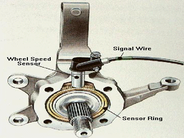

Hit a pothole with my Accord and damaged the right Front and Rear rims + tyres damaged
Rims have been fixed and wheel bearing replaced.
After this was done the VSA light remains on even after resetting the fault codes.
Prior to changing the bearings and after hitting the pothole this was not the case – no warning lights were displayed
Diagnosis from Honda WestRand (South Africa) is that the ABS sensor is blown. They cannot supply the sensor alone – but the entire unit.
This is not available locally – COST = R28 000 inclusive.
