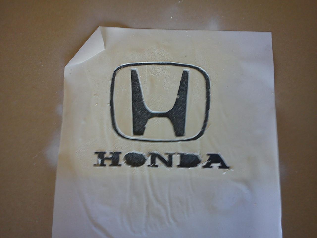

2. Print the logo out at the size you want

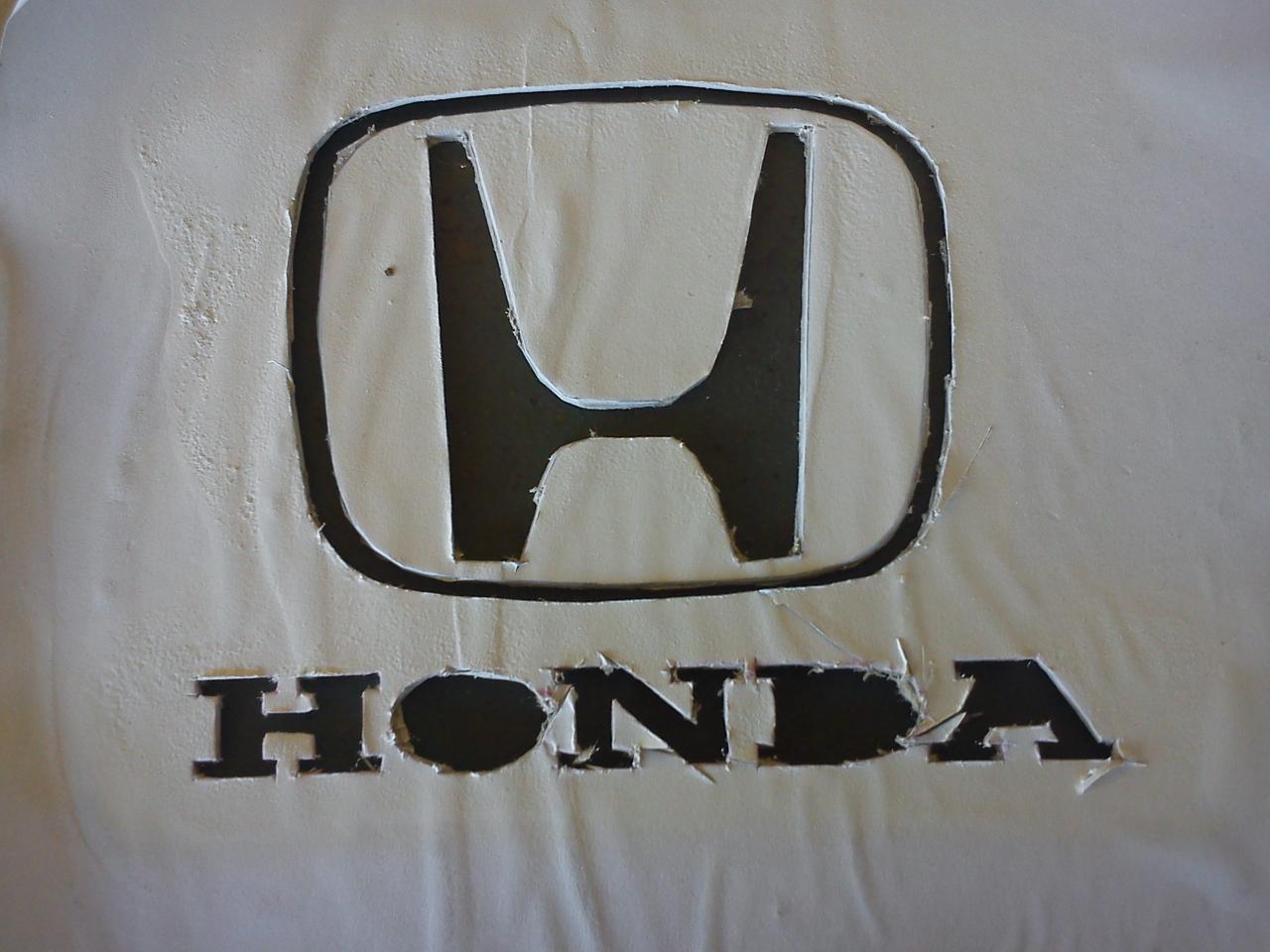

3.Glue the logo to the carboard. keep it square to the carboard which makes it easier to to alling later on the mat
4. WIth stanley knief and ruler, cut the logo out.

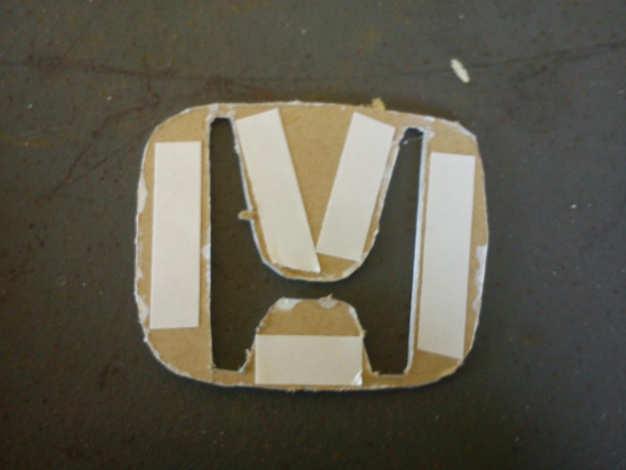

5. Apply double sided tape to the rear of the carboard stencil
Attachment 16533
Attachment 16535

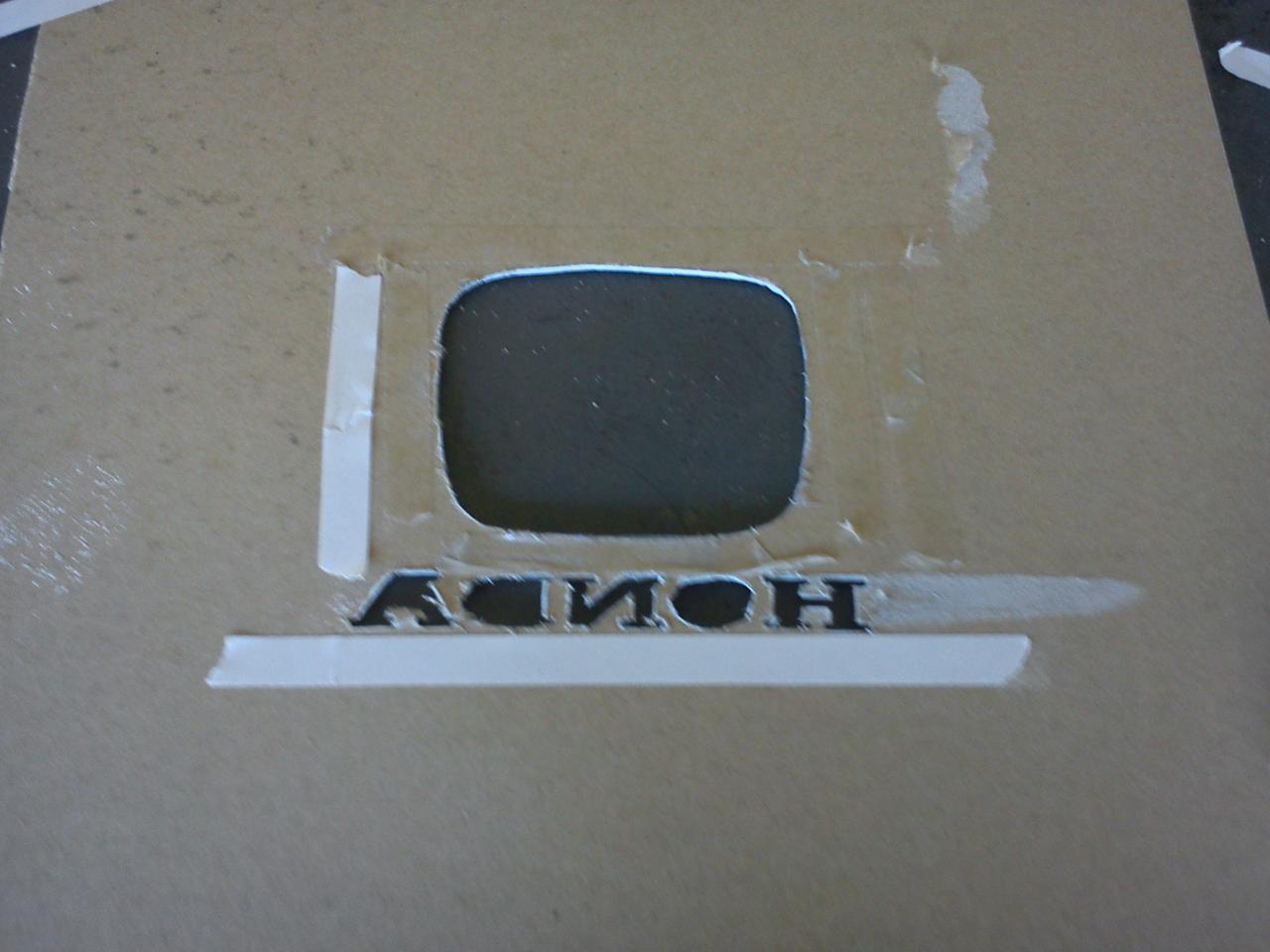

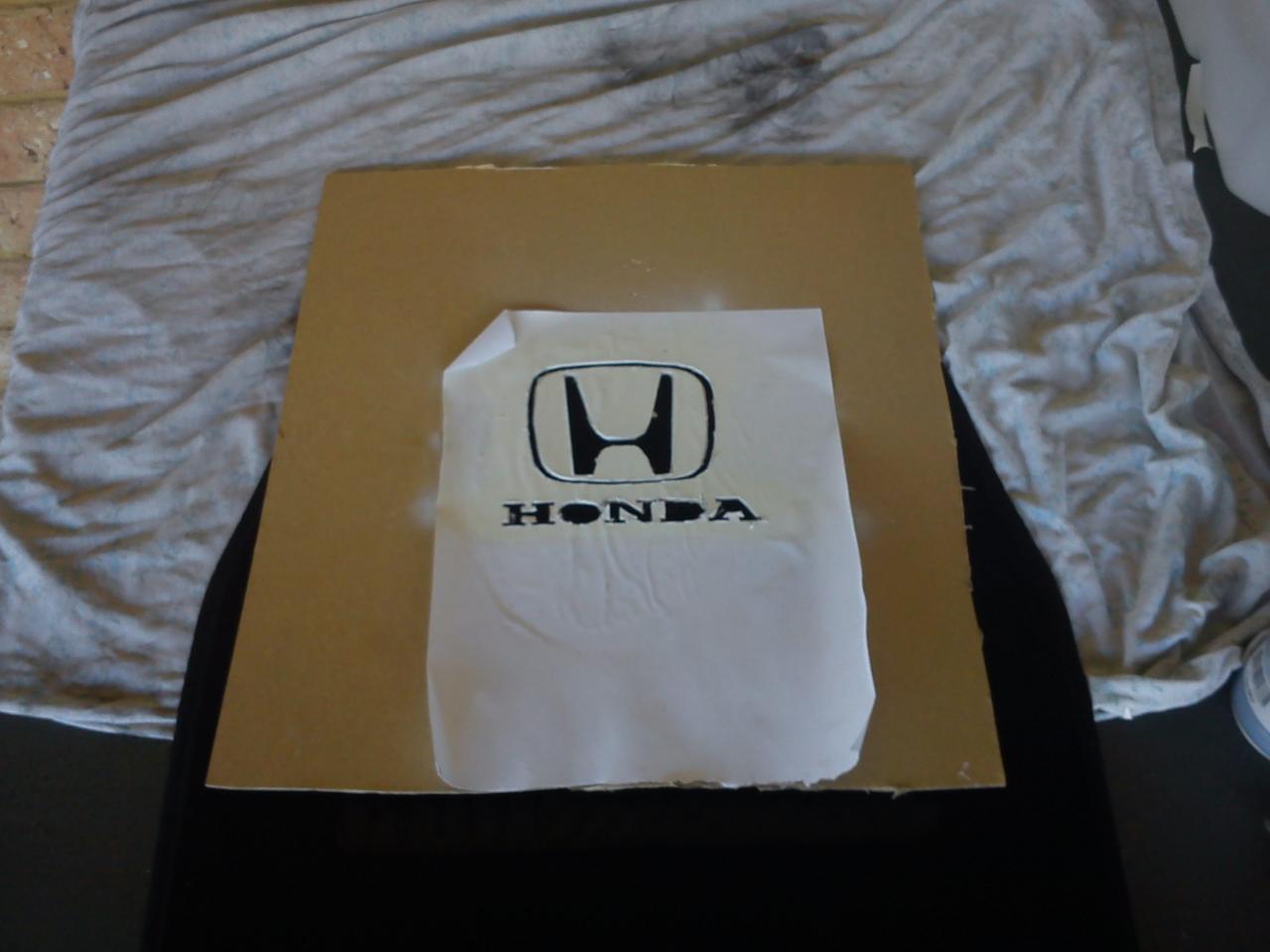

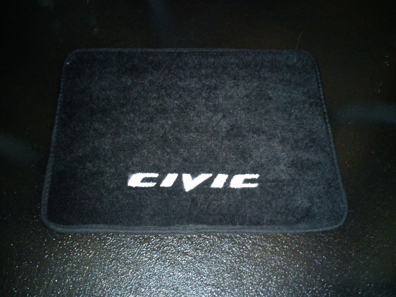

6. Place stencil over the area you want the logo to be and stick down hard (the better the last two step are done the better the image produced so take the time to get it right)
Attachment 16532
7. Apply a coat of the white spray paint. Allow to dry. and repeat 5 or so times. (or more if you wish)
Attachment 16530

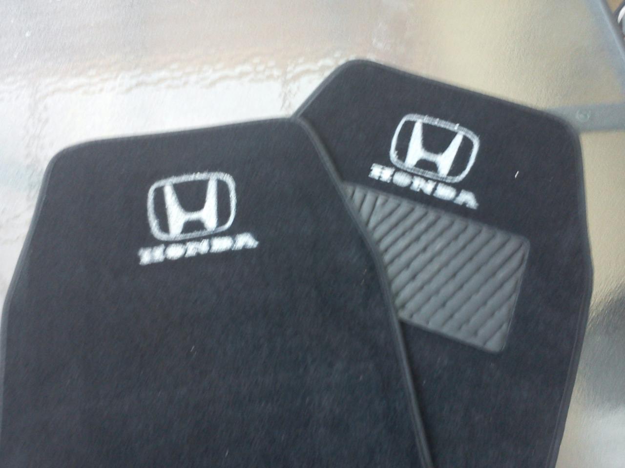

8. Remove stencil carefully ( i found peeling it back from corner slowly stopped any residue spilling onto the black areas)
9. allow to dry well before use
Attachment 16528
Attachment 16537
10. This can be repeated for just about any logo and looks great with internal neons. :)
