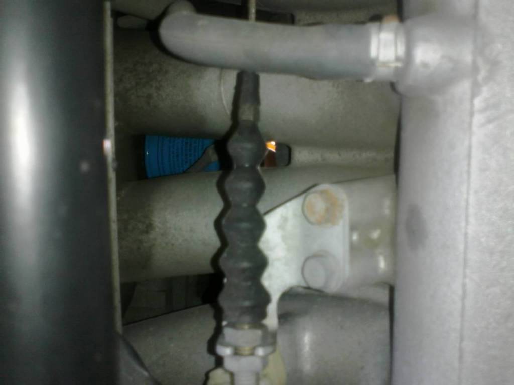

3. Once you've put the plug back in you can take the oil filter off, special oil filter wrench is only needed if the filter is on super tight. From under the engine you will have to reach up for the filter, its right under the intake manifold. What i do is get some rough sand paper, wrap it around the filter for grip and then unscrew it. Works every-time for me. Hold the filter steady, oil may dribble down when you take it out.
Sorry its a lame pic... this is the intake manifold from above, see the little blue thing? Thats where the oil filter sits.
http://www.ozhonda.com/gallery/data/...011146-001.jpg
