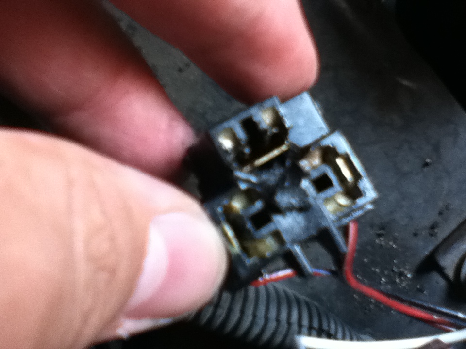

Heys guys i own a civic ek hatch 00', im having some trouble and my driver side light plug or something burnt out. i want to know what this plug is !
Attachment 18173
SORRY IF ITS NOT CLEAR -
CHEERS!
Attachment 18173
CHEERS!
happened to me last month in the EG sedan - same harness
goto Auto1 - show them the plug (walk the guy out to the car and show him) they will sell you a narva replacement for $10 each (or something like that)
remove neg batt terminal, use a wire tool or a knife to cut and strip the wires and remove the dead harness - solder the new harness on - put some tape around the solders, reconnect batt terminal = win
