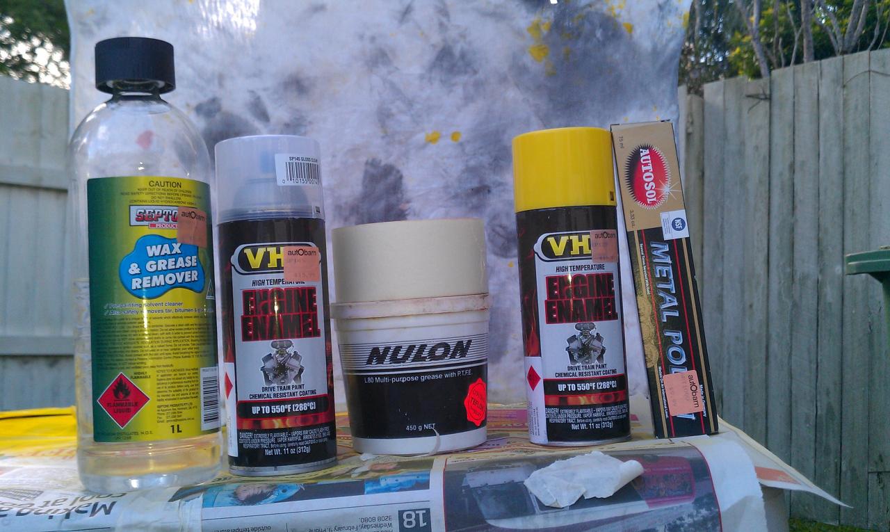

Required:
1) Masking Tape
2) Scourer or something alike
3) Paint Stripper
4) Sand Paper
5) Metal Polish
6) Grease
7) Wax and Grease Remover
8) Stanley Knife
9) Paint Scraper
10) High Temperature Enamel Paint & Gloss
Attachment 18465

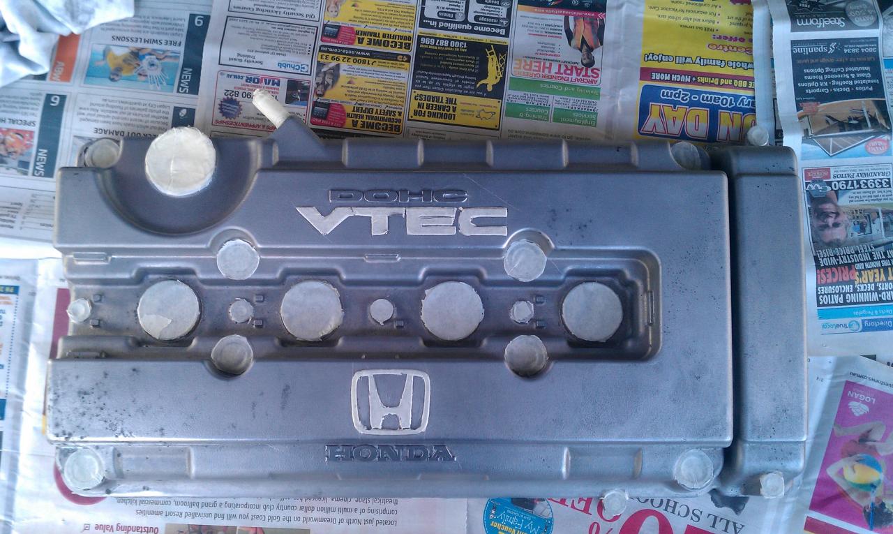

5) Now your ready to prep your cover for painting. This process takes a while, so be patient. Cover all the neccessary holes with masking tape (see picture) so paint cannot get in. For this process I covered the holes with a bigger piece of masking tape and used a knife to cut around.
6) This step is optional and very self opinionated. I covered the VTEC and Honda badge with masking tape and cut around it. This was not as easy for the 'dohc' and 'honda' so i left it to be painted and later on might just scrape off the paint.
THIS IS HOW IT SHOULD LOOK BEFORE PAINTING

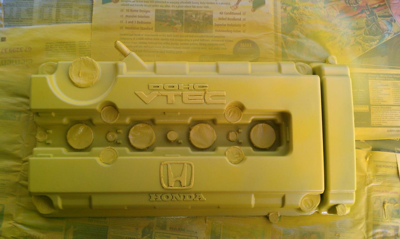

7) After ever thing is covered, it's time to paint. It will take about 4 - 6 coats, with about 20mins drying time in-between. I applied my coats horizontally, vertically and diagonally to get a nice even paint finish.
8) Let the paint dry a considerable amount and then apply approximately 3 coats of the gloss finish, just to bring out the colour that little bit more.

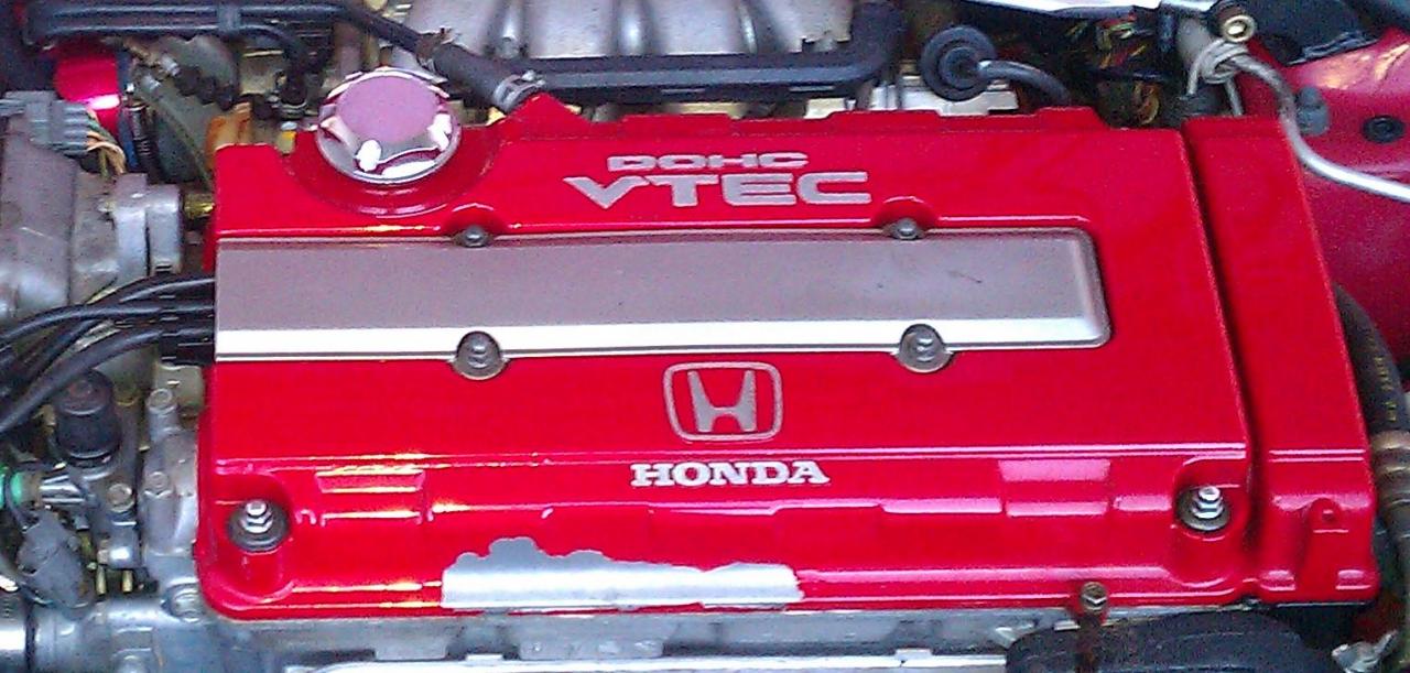

FINAL
Attachment 18467
