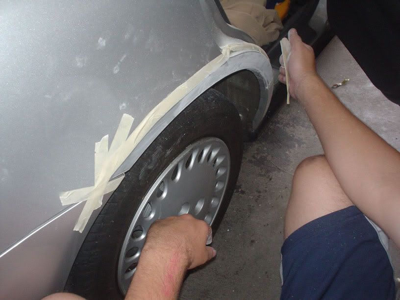

Steps: Roughly Mask Around area where there is rust. This is so you do not sand n e more that U really need to.
Using ur rougher sand paper, sand the area where the rust is visible until u cant see anymore rust.
http://img.photobucket.com/albums/v47/aimre/sanding.jpg
Once all rust is removed, use the 200+ grit sandpaper to smoth out the area. Once the are is smothed, wipe residue with a dry cloth.

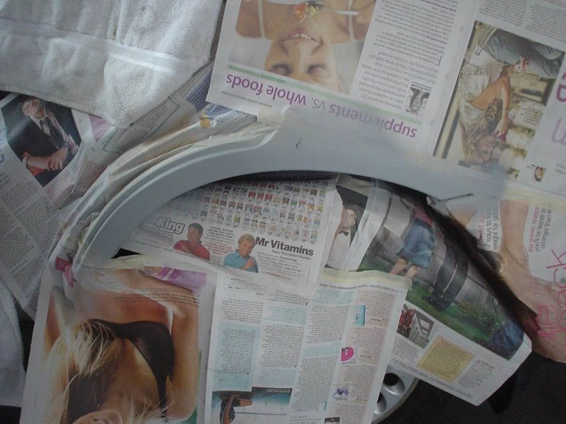

Remove the roughly applied and re-apply masking tape correctly and use newspaper to mask the car from over spray.
http://img.photobucket.com/albums/v47/aimre/masking.jpg
Now apply 1-5 coats of primer to the area (allow atleat 5 min between coats or refer to primer canisters instructions)
http://img.photobucket.com/albums/v47/aimre/primer.jpg

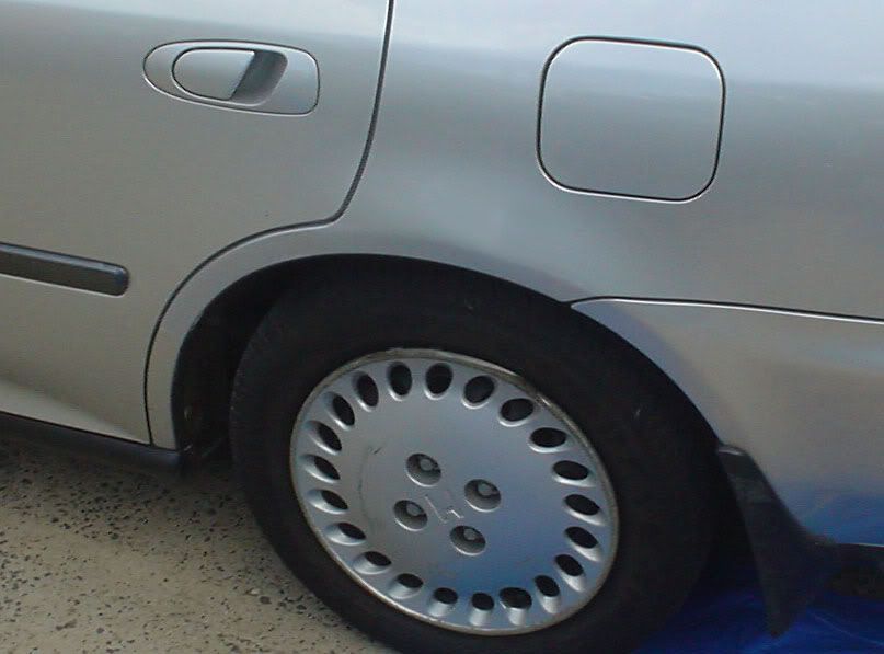

http://img.photobucket.com/albums/v4...e/finished.jpg
Now ur done
