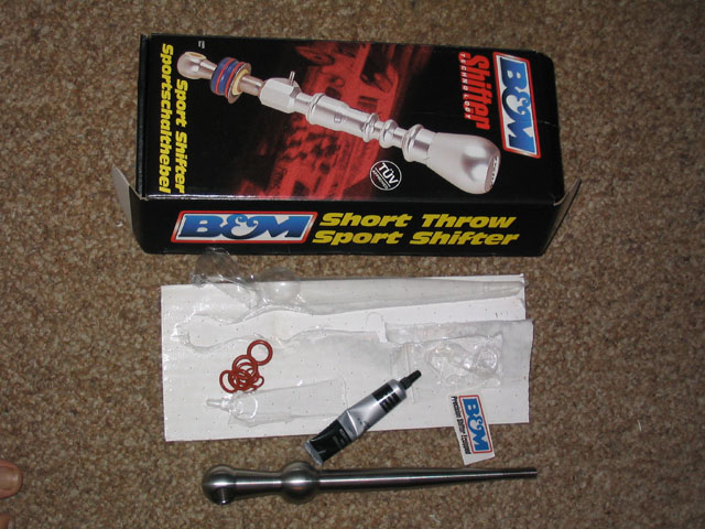

I'd firstly like to thank Trav (egsi) of Underground Imports for sending me this shifter in super quick time (and also for his funny comments on the packaging).

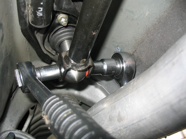

So that is basically it, the shifter has reduced the throw substantially as expected with a much more direct feel.  The instructions provided with the kit were pretty easy to follow after a bit of reading, but I though i'd post up some pics and write my own little guide (which can be used for any shifter pretty much).

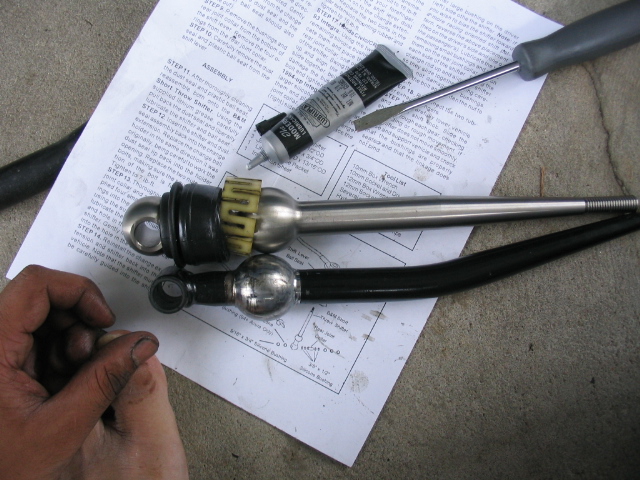

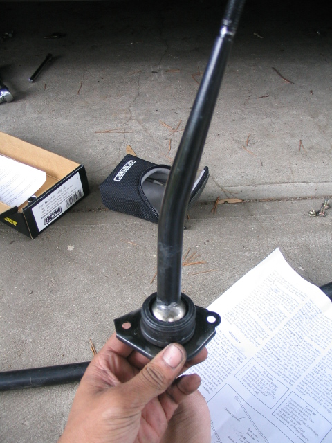

My only concern was the fact that the B&M shifter does not have a bend in the shifter which keeps the gearknob sitting closer to the driver.  With the new B&M shifter, the gearknob now sits a bit too far forward for my liking.  Note the bend in the stock shifter half way up?
http://www.ozhonda.com/gallery/data/2/3IMG_5633.jpg
So here's how to install the B&M short shifter..........
