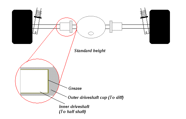

The half shafts are the center of all these problems. From the diagram below, the half shafts are made up of a shaft sitting inside a cup of grease basically. It is designed this way so that when the suspension compresses, it has some compliance to avoid destroying the half shafts/differential (Imagine gluing a twig to a single point, then at the other end pushing in/down on the twig… something will break!). This is essential for any Independent Rear Suspension setup.

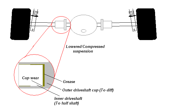

As the suspension compresses, the half shaft will move out of the cup at an angle. This drags the tip of the half shaft (a spider also known as) along the walls of the cup and over time will create a pit in the cup as shown in the 2nd diagram (the grease helps to avoid excessive friction). This is fine if you stay at the stock height but eventually, even at stock height (although this would take a while), the pit will grow large enough for the half shaft to “pop in” and “out” of which creates the vibration along the half shaft and into the rest of the drivetrain which then connects to the body (For example, grab a toy car – put the front wheels off the edge of a table then back onto the table, then off and on. Do this quickly enough and the car will somewhat “vibrate” like the half shaft moving in and out of the pit of the cup).
Attachment 20955
When the car is lowered or even if the rear wheels are cambered heavily (due to the angle of hub to the LCAs and half shaft), this will only accentuate the problem. The half shaft sits even further out of the cup "presetting" the half shafts to vibrate... if that makes sense.
