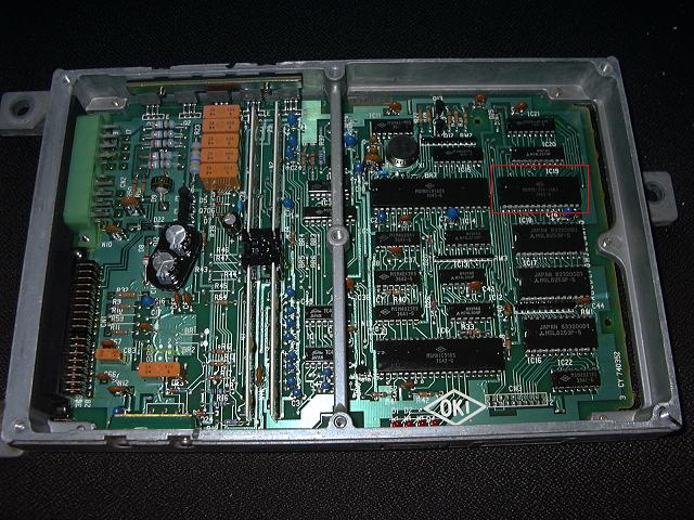

Warm up your soldering Iron.
While its warming up get some small wire cutters (finger nail clippers work too) and cut each leg of the 28 pin rom.

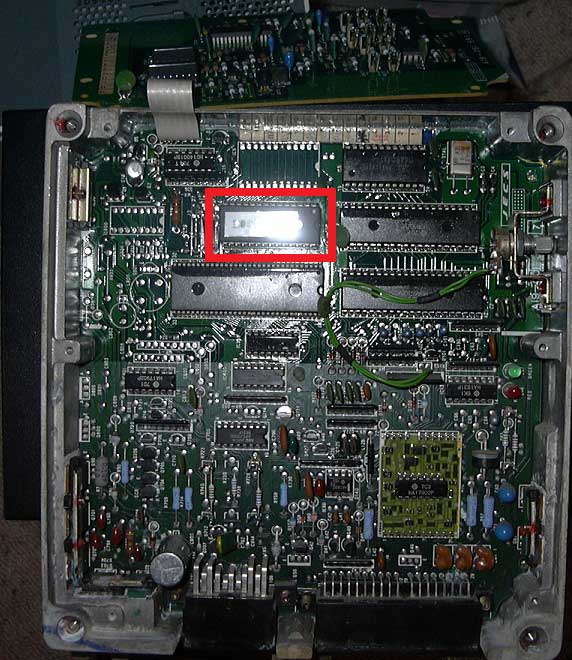

Attachment 21620
Rom
Then take a hair dryer and warm up the chip so the glue loosens and you can pull it off.
Now take your solder sucker and remove each leg thats left in the PCB
Make sure the holes are nice and wide open.

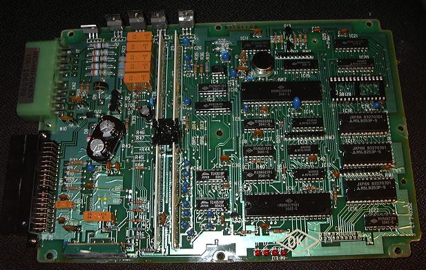

Attachment 21622
Now check that none of the traces are torn and take some isotopic alcohol and clean all of the left over glue off the PCB.

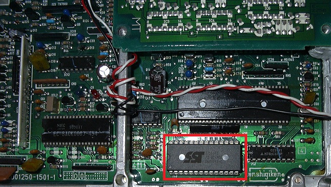

If everything checks out insert your socket and solder each pin back in.
Attachment 21621
Check with your multimeter for any shorts between pins.

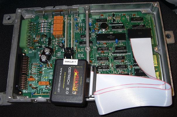

Now insert your chip with the City Turbo T2 map (or in my case im using an ostrich 2.0)
Attachment 21630

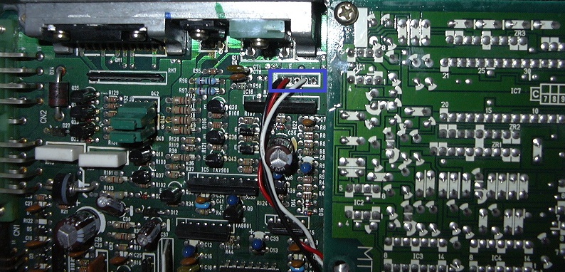

Data logging port:
CN3
No datalogging yet.

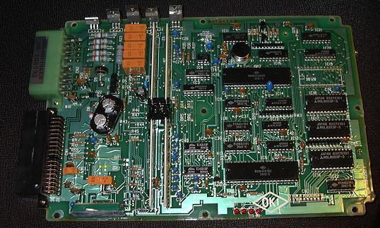

Chippable ECU:
PR3
PW0
Difficulty 3/10
Method:
Warm up your soldering iron.
Once warmed up take the de-soldering braid or solder sucker and remove the solder from the back of the stock chips pins so you can remove it. (A quicker and easier way is to just chop the legs then de-soldering them one at a time also your less likely to damage traces this way.)
Once the stock chip has been removed make sure the holes are nice and open a bit of flux will help with soldering the socket in.
Now insert the 28 pin socket and solder the pins into place.
Insert your new chip into the socket making sure the notch (half moon) is the correct direction.

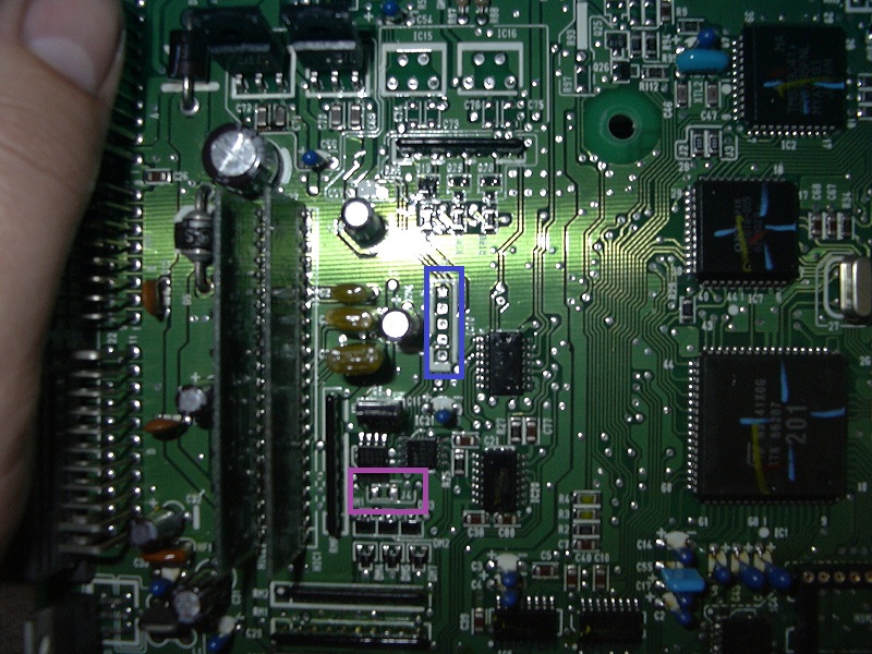

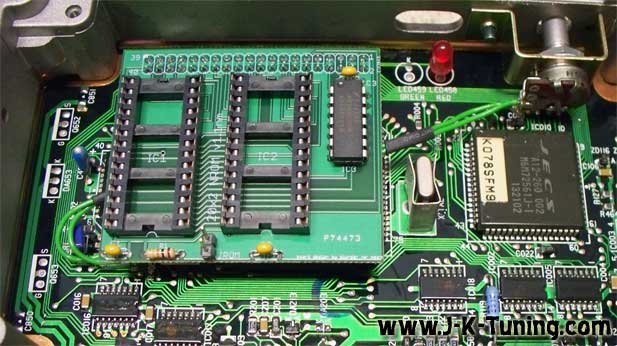

Attachment 21623
Area to work with (mine is already chipped so cant show you what it looks like with stock chip and what it looks like once stock chip is removed)
Attachment 21624

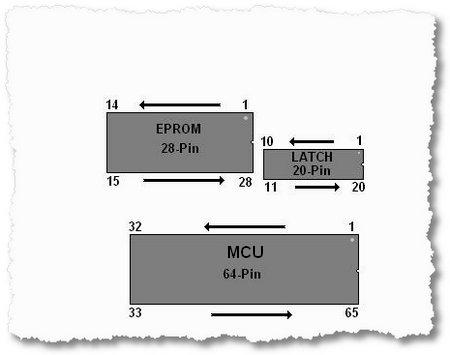

Attachment 21625
Image from PGMFI.org

If your ecu is one that doesn't have the latch present then that's the first part you should solder on. There are 2 methods for this. Either use a 10 pin solid center ribbon cable. Solder each pin and make sure there are no bridges. Then solder the ribbon cable to the chip. The other method is to solder the chip directly onto the ecu. If you have the slim 74hc373 this is quite easy, If you have the non-slim 74hc373D this can be a bit harder but not impossible. It just requires you to bend the pins in a bit. Make sure you mount the latch in the correct direction.
Once you have the latch soldered in you want to test to make sure all the pins are connected correctly.
Test pinout:
ECU - Latch
1-----20
3-----15
4-----12
5-----16
6-----19
7------9
8------6
9------5
10-----2
11-----3
12-----4
13-----7
14-----1 & 10
15-----8
16-----18
17-----17
18-----13
19-----14
(Pin 11 on the latch goes to pin 22 on the MCU)

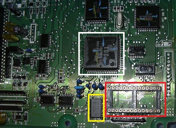

Attachment 21628
Socket
Latch
White is the MCU

Data-logging port:
Pinout top to bottom:
5: Nothing
4: TX
3: 5V
2: RX
1: Earth
Only Earth,RX and TX are required to data log.
Data-logging requires a serial TTL converter.
J4 needs to be unbridged to enable datalogging.
