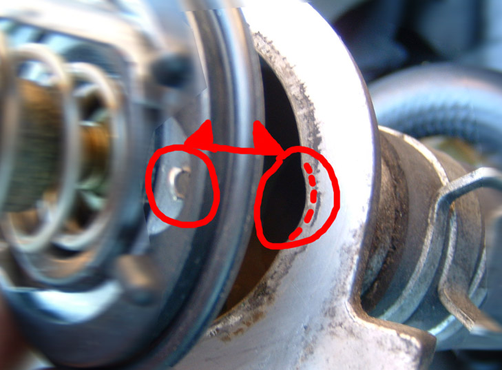

http://www.ozhonda.com/gallery/data/500/79131.jpg
Place new thermo in exact position - following the slight groove in the housing with the bypass on the thermo.
