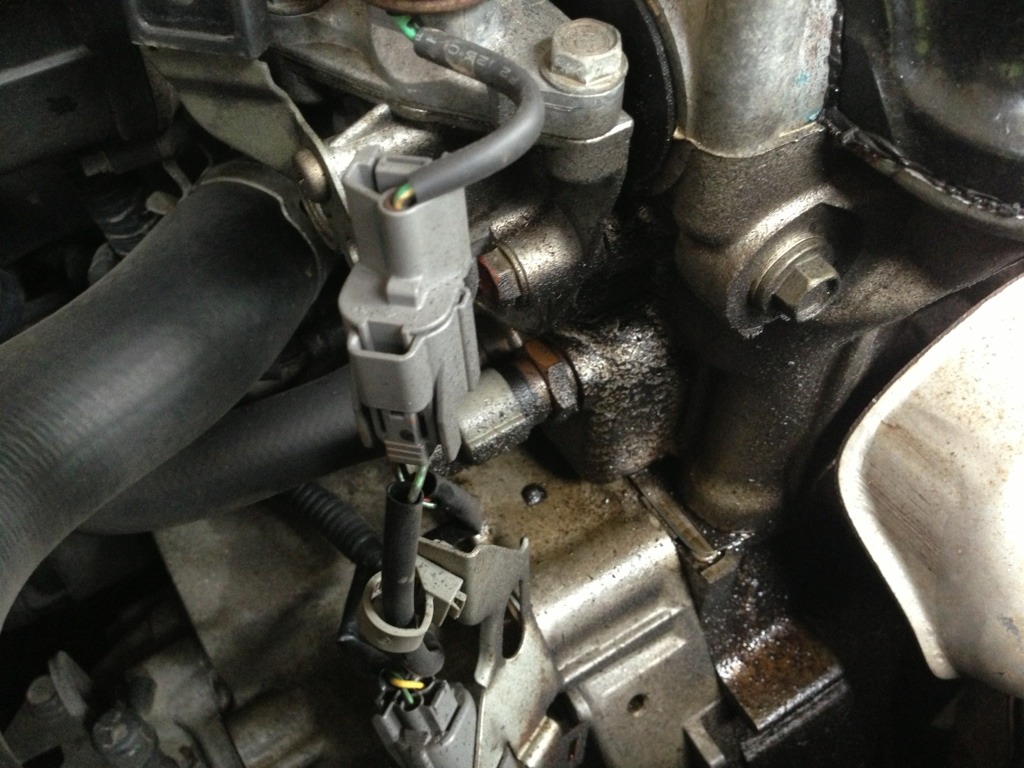

On the top part of the engine block I've notice a slight leak around the vtec solenoid.
I've heard that its a common leak but I just wanted to ask u guys if its a serious one and of its just a gasket or something that needs replacing.
Attachment 23857
Not a big problem. Change the gasket, hose down the engine bay. Change the solenoid while your at it. But yeah, it is a common problem.

pardon my ignorance - why change soleniod? I thought it's only a seal?
looks like my prob,
ive just change solenoid seal and cam seal plug, havnt seen leak so far its been around a week.... my leak was same position
ive change my gasket around 40k ago so didnt need to change that, but if you havnt changed yours then do that as well and clean up that oil leak

Before u buy gaskets/seals that u prbz don't need, try identify where the leak is coming from.
Could also be from the dizzy O-ring or even O-ring in the dizzy.
Put ur finger under the dizzy and see if it has oil.
But yeh could be any gasket/seal
-vtec solenoid
-valve cover gasket
-exhaust cam seal
-dizzy o-ring/s
Alright ill probably degrease and hose down the block. That way I should be able to trace where exactly its coming from.
