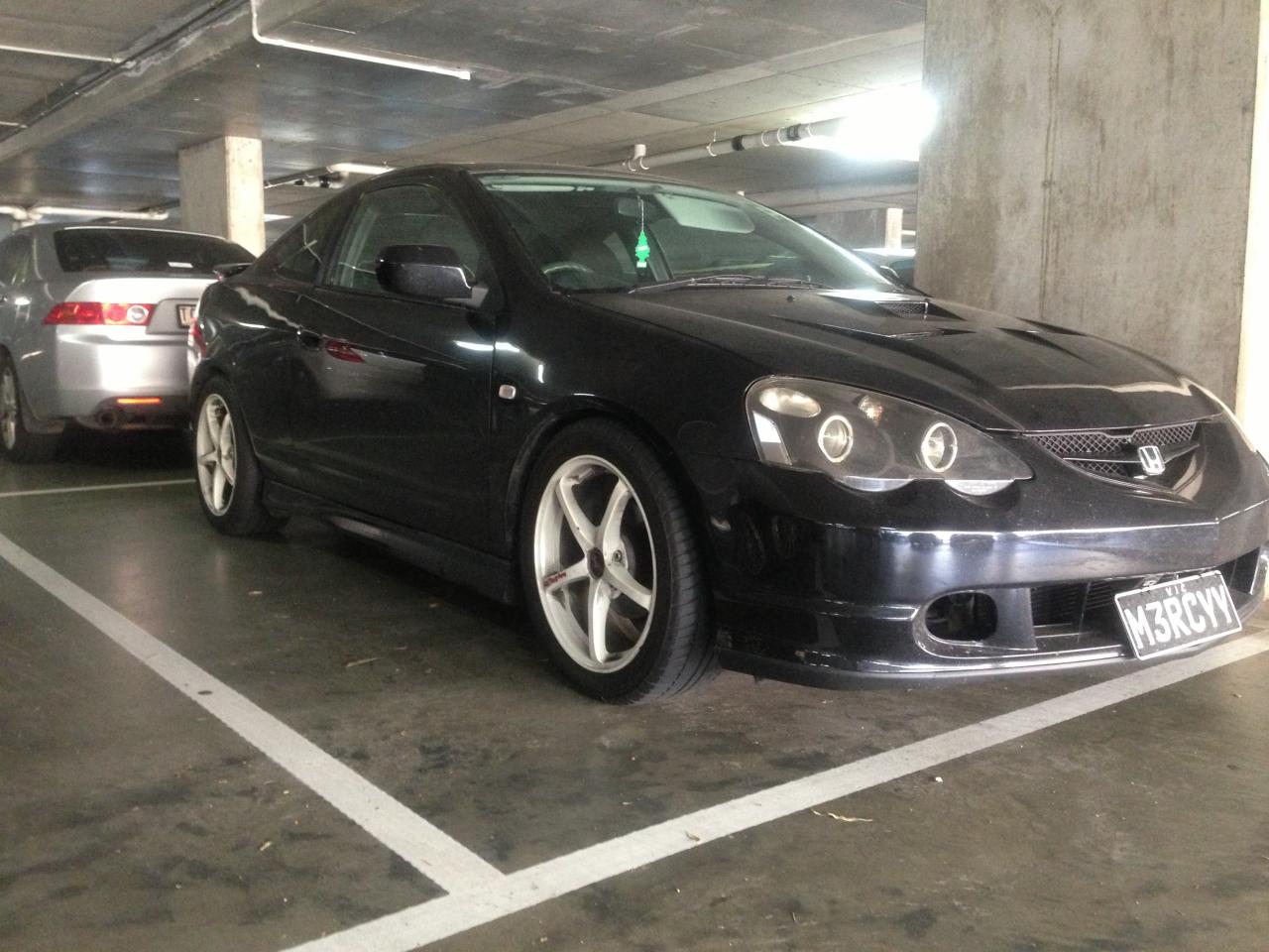

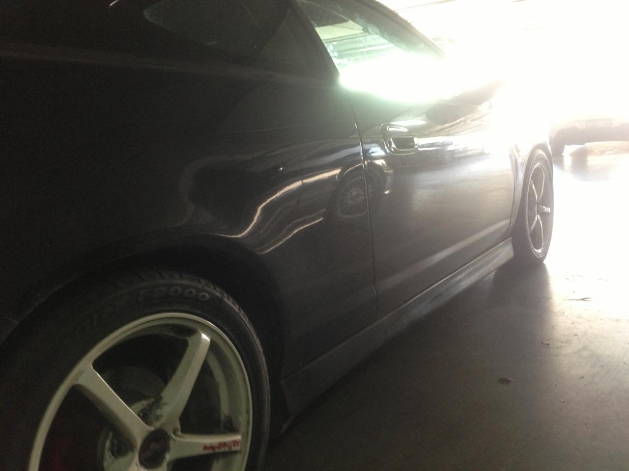

BEFORE
Attachment 24536
AFTER
Attachment 24537
Attachment 24538
