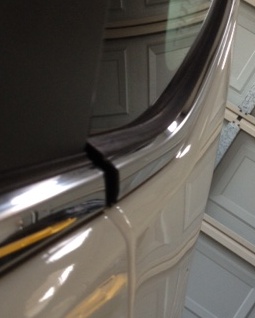

2. Rear quarter glass chrome trim alignment issue. The Chrome trim bonded to the rear quarter glass does not line up with the chrome strip on the rear door. One side of my car is fine the other side is shows a noticable mismatch. Dealer solution was to replace the rear quarter glass, duly done and not much better. The dealer can't do much more and I may have to live with Lada like trim alignment. The dealer showed me serveral CRVs, some were perfect but most had alignment problems, also looks like a known issue... very un-Honda like build quality glitch.
