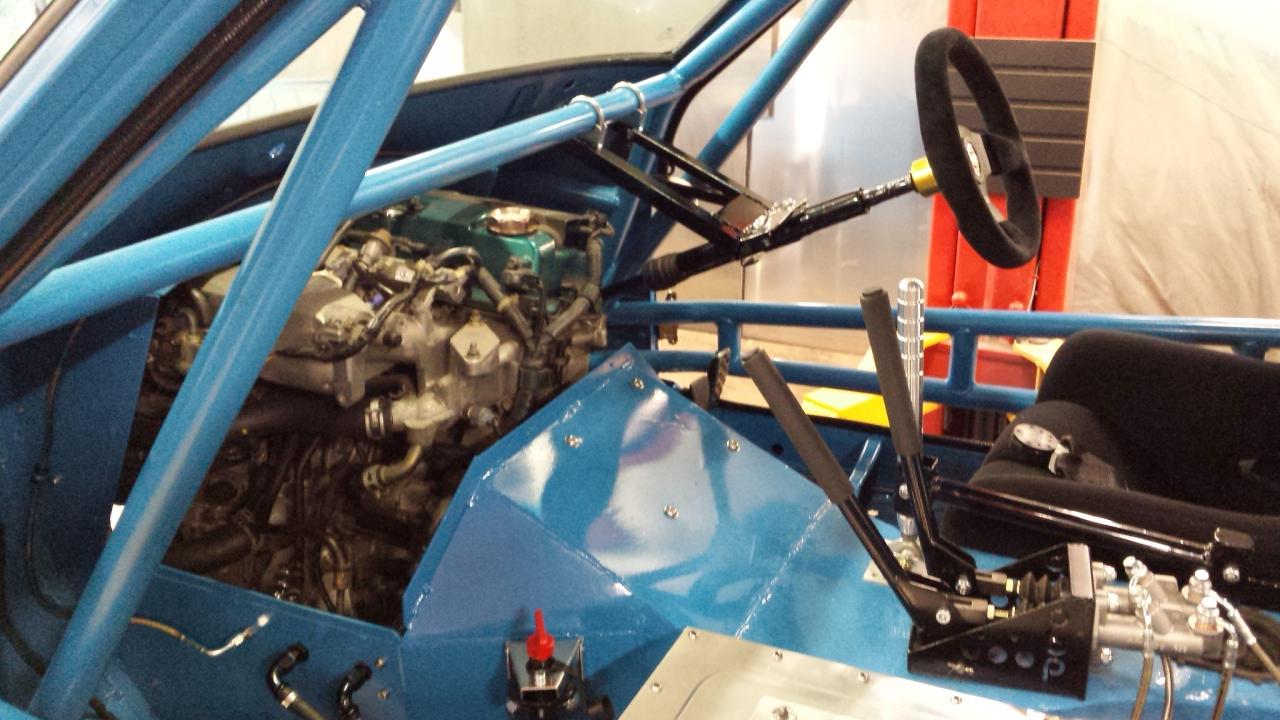

I am building a race car and have bought a S2000 front cut from the wreakers
to get the best under 2 litre motor ever built. (F20C)
The problem is the front cut did not come with any keys or remote fobs.
The motor and gear box are installed in my race car and I am attempting to
wire and start the engine.

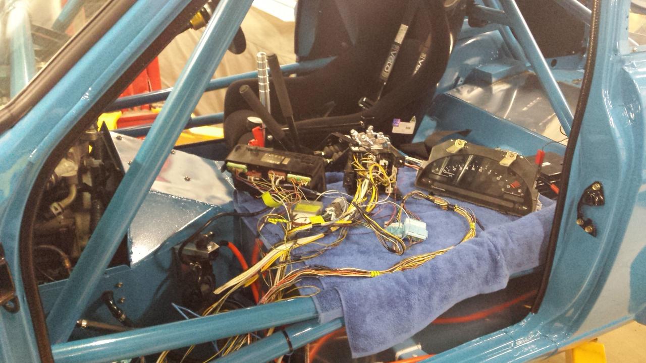

When the ignition is turned on:
The dash will go through its start up procedure,
the fuel pump will start,
when the start button is pushed the motor will crank
but not start.
The question is: does the keyless remote stop the motor starting?
My assumption is that it does but I can not tell how as there are no
signals going into the EMC control box from the lock and keyless controller.
(the front cut has come from Japan so may be different from an Australian delivered model)
The keyless controller is an Omron G8D-454H-3B.
does anyone out there know what the keyless controller actually does
and what the Pins in the connection plug actually go to?
