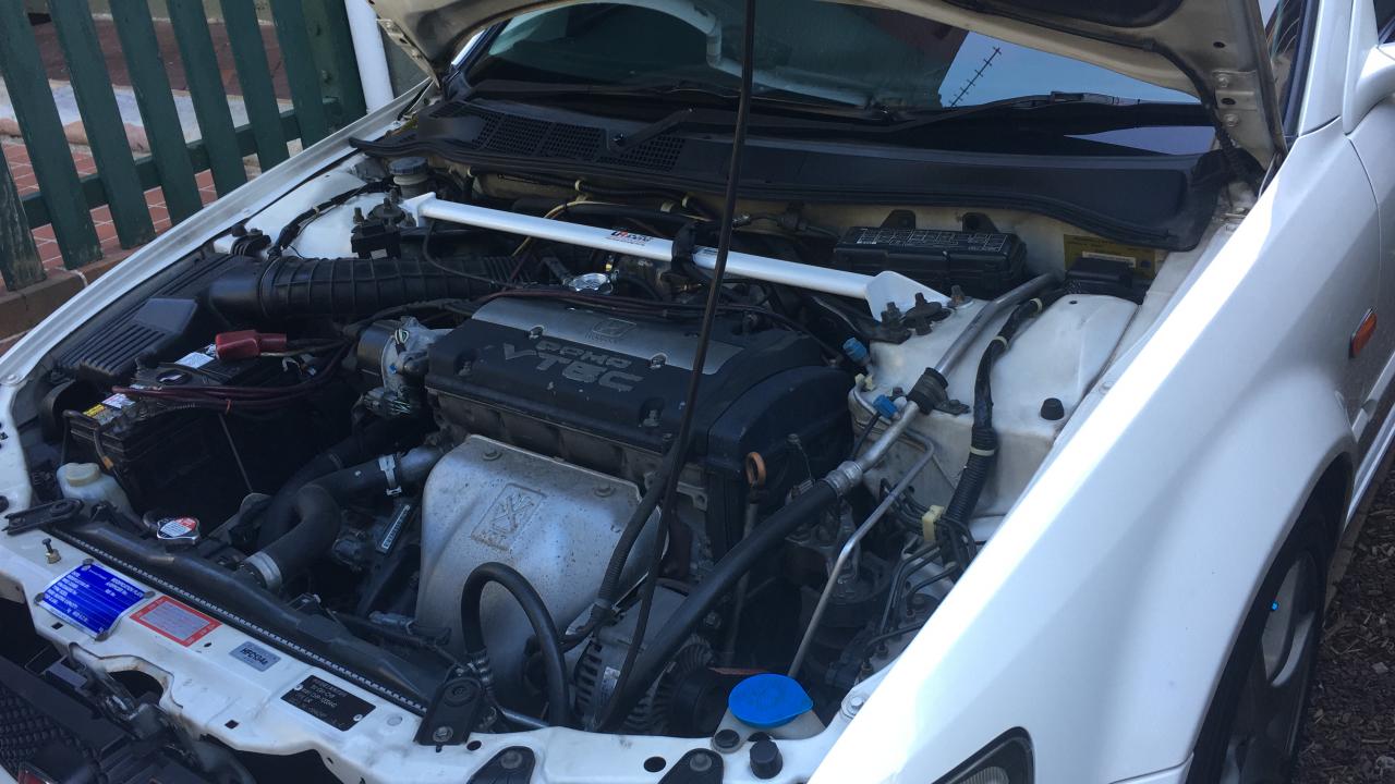

lol.. dc5r uses k20 engine and 6 speed. So you do not have that gearbox.

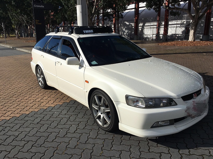

What you have is a 6th gen wagon accord with a h23a.
There were no cars that came with the h23a in Australia. Closest is the h22a from the prelude.
Basically the body parts may match the 6th gen accord, and a lot of the engine parts would match the prelude and to some extent accord.
But you will have heaps of unique parts to that model, especially being the JDM sports variant.
Basically what you would want to service is like any accord or prelude of that generation.
Oil, oil filter, genuine rad fluid, thermostat, air filter, gearbox fluid, fuel filter.
