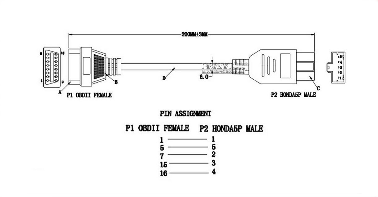

I'm looking to perform upgrades to my 2000 HRV but first I want to know what it's doing now. So I've bought one of those WIFI OBDII dongles and when I went to plug it in I discovered that the holder that houses the diagnostic port on the seppo HRVs is vacant!
I've looked under the dash and around near the fuse box, behind the lower glove box and near the computer but the mongrel thing is nowhere to be found!
Does the Aussie HRV not have the diagnostic port?
