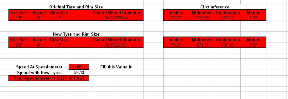

you can use the Tyre Size comparison table
http://www.ozhonda.com/forum/attachm...2&d=1215992898
and before you begin.. at the top of each tab there is a Table you need to enter your specific variables (ie, Tire size, Rpm Shiftpoints)
http://www.ozhonda.com/forum/attachm...3&d=1215992898
