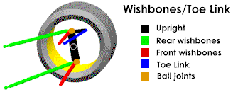

 Uprights (Wishbone suspension)/Knuckles
 The upright or knuckle attaches the wheel, brake rotor, hub, brake caliper and steering arm to the car (of course, the wishbones and control arm(s) do the final attachment to the chassis)
 The upright or knuckle determines the king-pin inclination, and the final camber, caster, and toe settings of the wheel and tire. These various factors are demonstrated in the diagram below.
 Castor angle
 If the lower swivel is further forward than the upper you have positive castor (aka trail). In this situation the centre of the tyre's contact patch trails behind the point where the king pin axis intercepts the ground. Thus
 the steering self centres, the drag on the tyre will pull it back behind the king pin axis. Just like a bike (push or motor).
 With things the other way round the steering would tend to un-centre itself (just like reversing).
