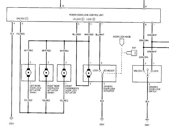

1 Attachment(s)
Attachment 5445
all u need to do is find the door lock/unlock trigger from your remote system module (find the positive trigger, as most universal system give u postive/negative options) and tap them to the WHT/RED and BLU/RED wire on the power door lock control unit in your car. This control unit should be inside the driver's door panel... the diagram is for EJ/EM but I assume the wire colors are the same
if not, what u can do is grab a multimeter and ground the black wire and put the measurement to 20V/AC then probe the door lock control unit connector and find the one that gives +12V "WHEN" u flick the driver's door lock switch. The one that gives out +12V when u lock the door is the lock wire and so on..
if your remote module does not have a positive output, then there is an alternative.. connect the trigger output from the remote module to GRN/WHT (lock) and GRN/ORG (unlock) wires on the door lock control unit as this switch is negative triggered..
Hope that helps...:thumbsup: :thumbsup:

i worked on looking for the power relay for my ek gli today.. before it rained, i couldn't find where it is under the steering wheel.. i'm thinking it's an oem from honda. i saw a box bolted on the panel under the steering that seems to be the immobiliser. i checked under the kick panel but it's not there...
i was looking at the diagram D4rk4n63l provided and trying to look for the colors that lead to the control unit but then that's when it rained. what would be the best way? just track the wire starting from the door panel?

i found the control unit and i've figured out the wires for the actuators and the motor.. what i don't know now are the green wires.. what are the green wires for? the remote entry unit i bought is best to replace the oem control unit because it's a control unit/receiver in one. but it only has 5 wires (incl ground) where am i to connect those green wires?
why dont you post up the wiring diagram for your new control unit.. see if I can match them, but additional control unit can work on top of the current system without taking the old unit out.. this is the best thing to do since there are some difference in the way OEM and aftermarket control units work. So, unless ur OEM control unit is stuffed, I dont see any reason to replace it...
Most universal aftermarket control units only need 4 wires connected (unless its a full alarm system) which are +12v, ground, lock, and unlock triggers. Some have a door switch wire for auto relock function and/or aux output for trunk lid opening and that's about it..

in this case, you dont need to worry about the trigger wires (green and blue) .. all u need to connect are the control wires (Brown and White, not sure which one lock and unlock from the diagram) and tap them to the GRN/WHT (lock) and GRN/ORN (unlock) on the OEM control unit,. You can tap the +12V to the WHT/GRN wire and ground to BLK wire on the OEM connector... this circuit is fused together with the OEM central locking system so in case there's a short you know which fuse to replace
that way, all u did was adding the remote function to the OEM system without altering anything to the stock configuration of the OEM central locking system
