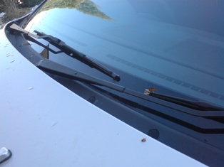

*Old looking windscreen wipers could be "re-vamped" by taking them off, give them a good wipe with alcohol, then spray them over with any colour of your choice.. in my case, I used satin black straight from a can..
Attachment 9103

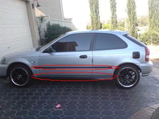

*Old looking sideskirts and door moulds, my solution was to wipe them down with bug & tar remover, then alcohol, then I went over it a few times with shoe polish!.. the stuff that comes in a bottle with that little foam thing on the end for application..
I applied 2 coats, let it dry a little, wiped it down then applied another coat..
Attachment 9105

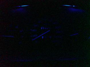

*Changed my cluster lights to LED's.. used blue.. they're alot brighter when you're actually there.. it's not very bright in the picture! I used 1 T10 and 5 T5 inverted led's..
Attachment 9110

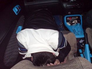

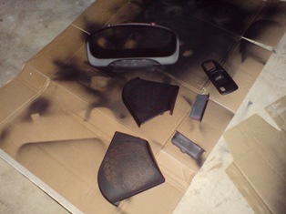

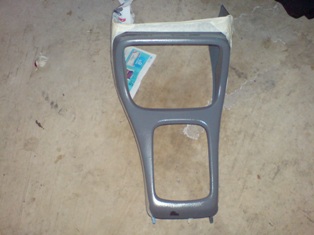

*Inside looking a little dull and boring?.. "Re-vamp" it up with some colour!!.. I've sprayed my vents, inside door trims and speaker covers.. I primed them with some Plastic Adhesion Primer, then gave it a few even coats of the colour of my choice.. I use to have blue, then Machinery Grey, and now it's finally black.. the paint I used is Vinyl Paint..
Blue:
Attachment 9106
NB: Disregard the drunk guy.. only picture I had with Blue in the car..
Machinery Grey:
Attachment 9107
Spraying it black:
Attachment 9108

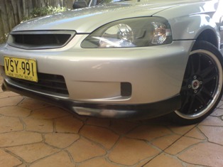

*DIY black housing headlights and a lip also makes a deal of difference..
Attachment 9109
