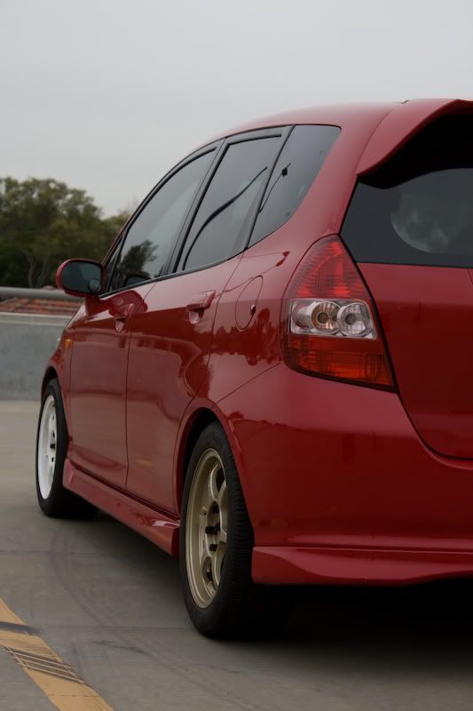

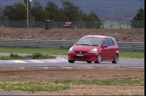

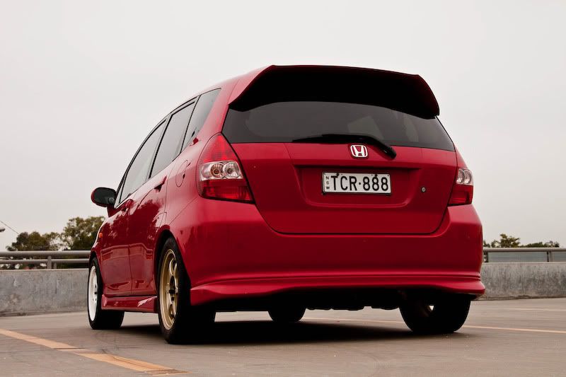

I highly rate the Tanabe DF210 springs. Pictures of it when I still had my Jazz.
http://i99.photobucket.com/albums/l2...8/IMG_5489.jpg
http://i99.photobucket.com/albums/l2...8/IMG_0597.jpg
http://i99.photobucket.com/albums/l2...IMG_0512-3.jpg
Lowest JDM spring with one of the hardest spring rates you could get.
http://i99.photobucket.com/albums/l2...y168/df210.jpg
Ran 1.19 on wakefield with RE001 street tyres
