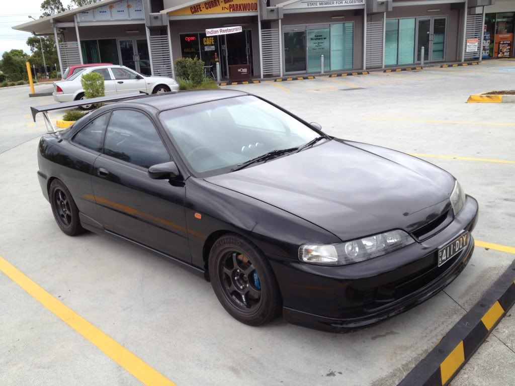

took the car to go buy some curry.
http://i1110.photobucket.com/albums/...i/IMG_0038.jpg
very clean!
paint looks pretty good now. did you end up taking it to a pro for a buff?
