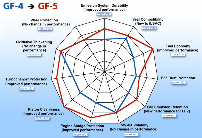

Here it is. the document from Honda.
Another reason I will be filling with GF5 (SN rated) 0W20 at my next fill.
Attachment 24144
*Please download this document if you wish, as I will have to remove it due to space constraints.

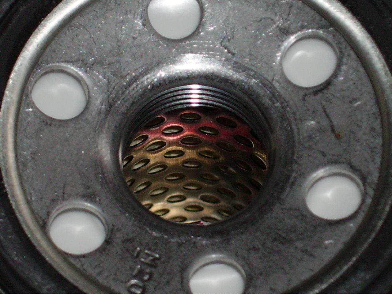

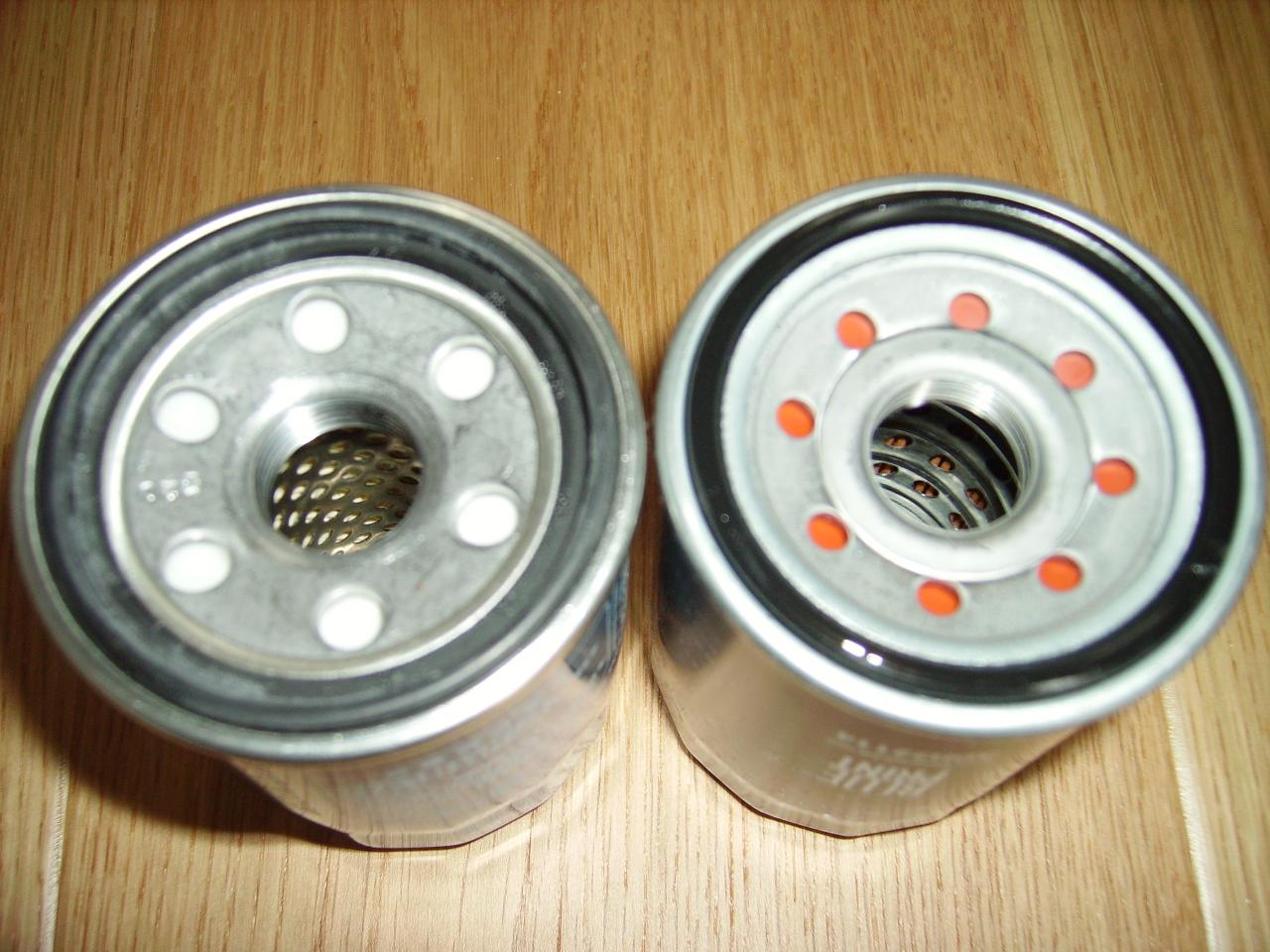

I went out and purchased a Honda oil filter and also a generic oil filter. The generic filter from my local auto shop cost less than half price (GBP 5.00) of the Honda filter which cost GBP11.30 inc tax.
Visually, the generic filter (on the right) looks pretty good and well made. It has a good quality O ring seal (which came lubricated) and the anti drainback valve is made of good quality rubber.
Looking inside The Honda filter (on the left) the anti drainback valve seems to be made of a high quality silicone rubber compound and the there is also a difference in the type of bypass valves being used. The larger holes in the Honda filter look capable of passing more oil through them than the generic filter.
Finally, and most importantly, looking closely at the filter medium, the generic brand looks to be made of vertically pleated paper and the Honda filter medium looks to be made of a polyester-glass type material.which has a cross hatch pleated layout, which I think may have a finer filtering/better performance and a greater surface area for the trapment of more debris.
From visual appearance alone, the Honda filter looks to be made of better materials and is likely to outperform the generic brand over a greater oil /filter change interval.
So, it seems that in this case, you get what you pay for.....

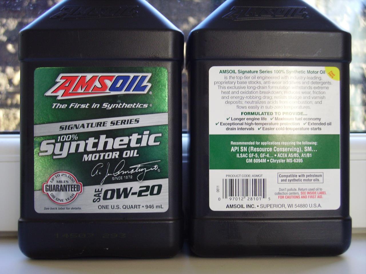

So, here it is.... Amsoil 0W20 GF5 SN rated oil, which I put into my engine today.
Why did I choose Amsoil 0W20?
* 100% Synthetic. There is no word play, and any attempt to pass off hydrocracked mineral oil as synthetic oil.
* Extended drain interval of 25,000 miles or one year.
* GF5 (group 5), SN rated oil.
* Only GBP 10.00 more per oil fill than Mobil 1 0W30 ESP.
Attachment 24222Attachment 24221
I will be testing this oil fully over the next few days and will post my findings.

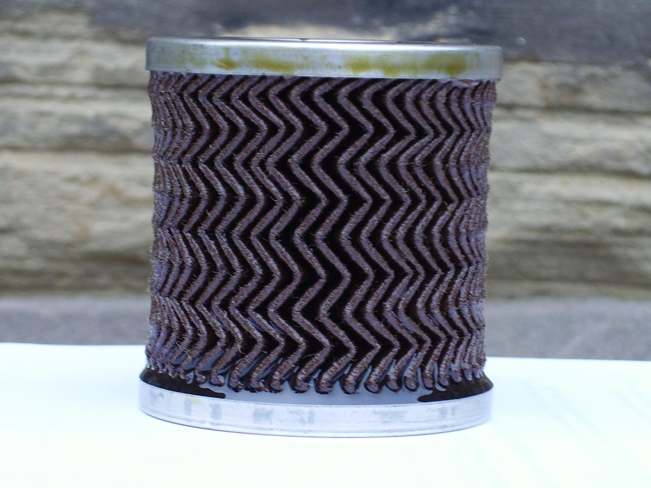

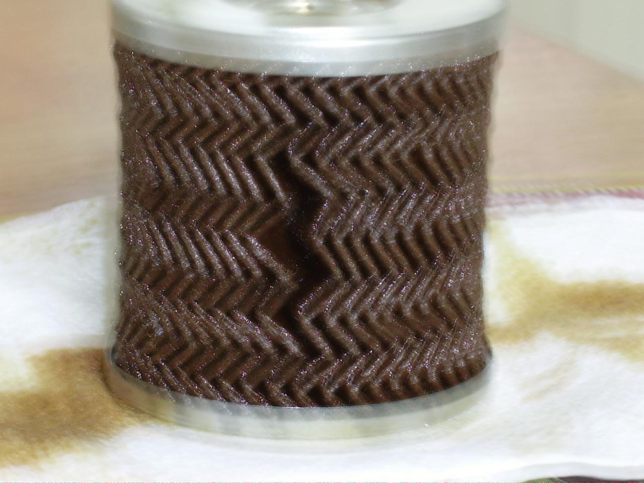

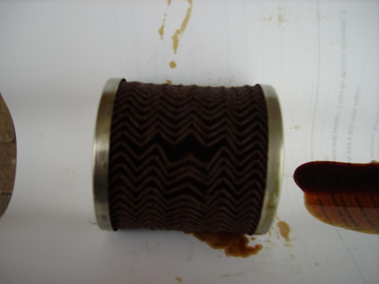

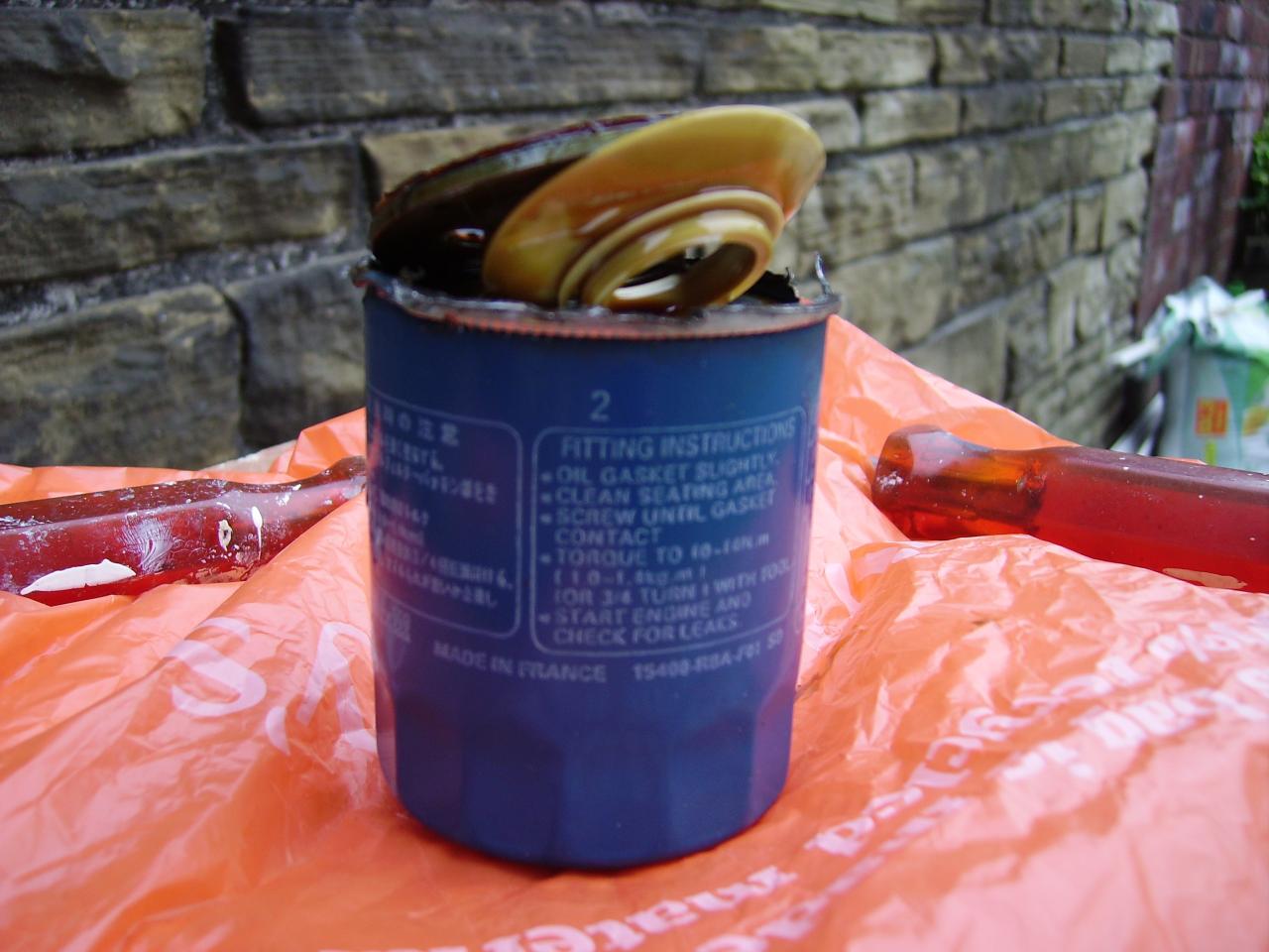

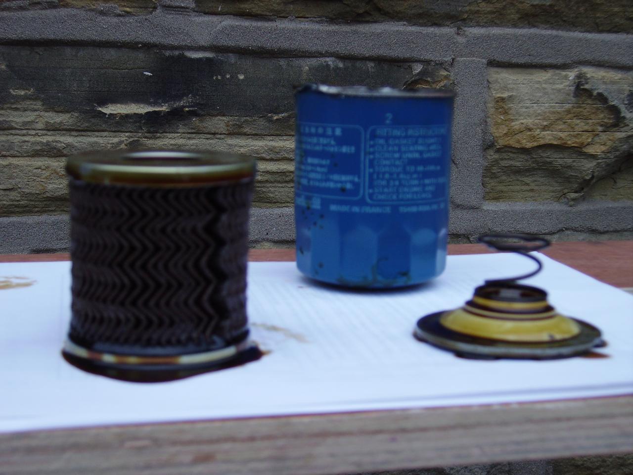

The oil was changed after 11 months - 8,000kms. There was no sludge, debris, or any particles whatsoever found. The old oil was Mobil 1 0W30 ESP.
The filter was cut open carefully using an angle grinder. No grinder dust was allowed to enter the inside of the filter.
Attachment 24230Attachment 24231
The filter core was allowed to drain naturally, and inspected closely.
We can see the cross hatch - saw tooth pleated polyester/glass filter media. This pattern seems to have more surface area for the filtration of the oil compared to a vertically pleated media.
Attachment 24232Attachment 24233Attachment 24234
Close visual inspection showed no visible particles, debris, metal shavings or sludge.
I ran a magnetic screwdriver along the crease of the pleats and found no metal filings or any other debris.
So, it seems that the oil has done a good job in protecting the engine.
