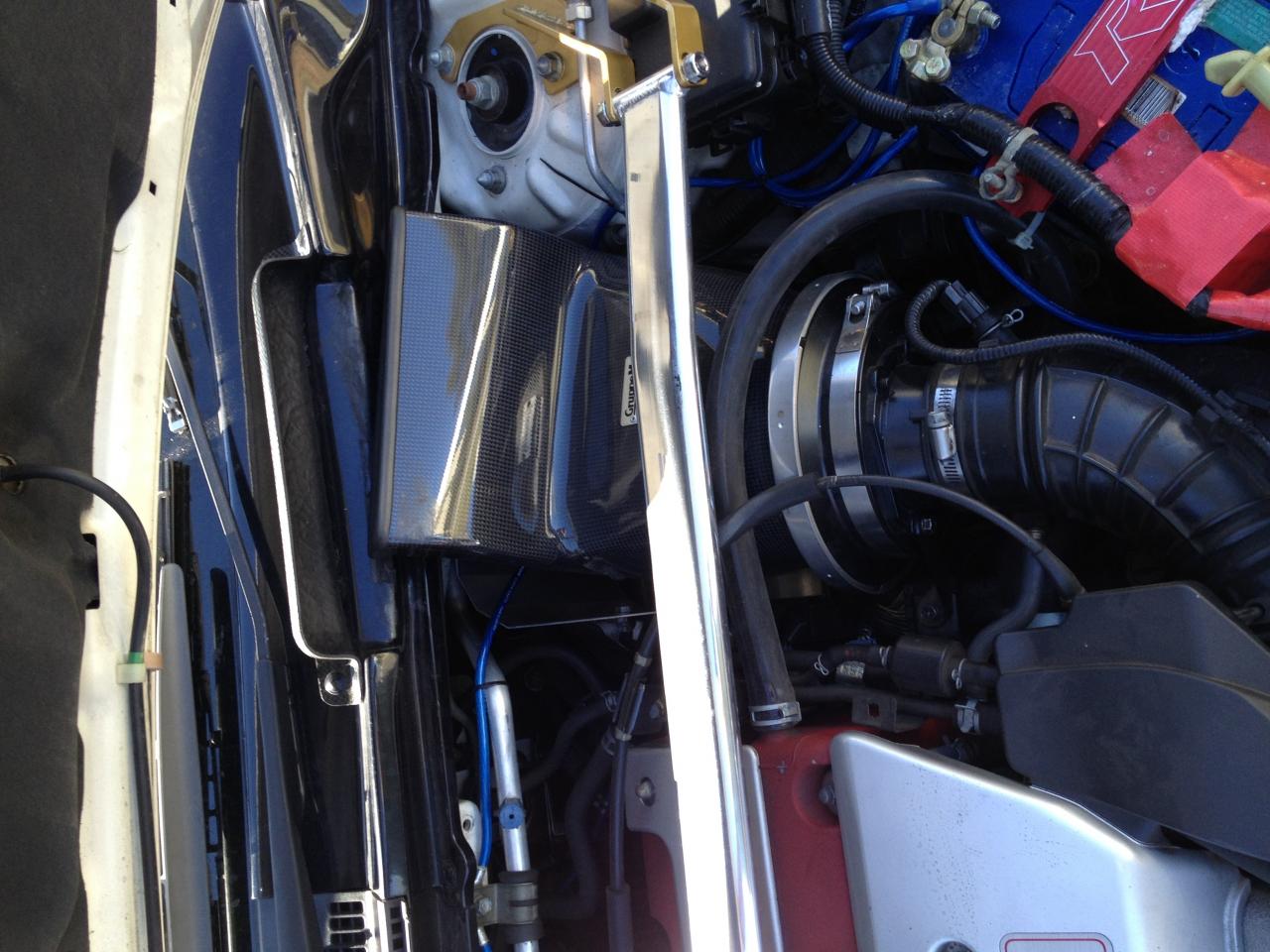

This is what I mean!
Attachment 23186
Attachment 23186
you dont have the mounting bracket.
See the silver band that tightens the intake to the intake arm ? Look to the left of this , there is a small nut. There should be a small L piece of metal that holds the back of the filter housing to the side of the engines head. This keeps the heavy gruppe m upright.
here is an image of the bracket on the back of the intake
http://i.ebayimg.com/00/s/NzY4WDEwMjQ=/$T2eC16RHJIkE9qU3kWRdBQ,DMSMsO!~~48_79.JPG
kenny07 looking at the pic closely, it looks like you have the L bracket already on it.
I'd try loosening the largest clamp and re-adjust it. Then loosen the smallest hose clamp which connects the gruppe m to the intake hose, and move the whole kit closer to the fire wall/scoop. Then should it move or slip later on, it should only move and hit the edge of the cowl.
I also put some small bits of double sided tape between carbon intake chamber and metal intake snout, to minimise any noise or movement.
Where can you get those mounting brackets from? As I need one since mine never came with it.
mines on and tight actually. tried tightening it but it wouldnt go any tighter! dont wanna break it!
ill have a proper look when i put in my induction hose i guess.
If u can spin the main body of the gruppe m then its not tighten down enough. Loosen the large clamp n make sure ur on properly then tighten till the main body needs resistance to spin. It shouldn't spin freely. If u really can't tighten up anymore then what u have then looks like a issue with the sizes of both parts which is preventing u to getting them both clamped down n tightened
