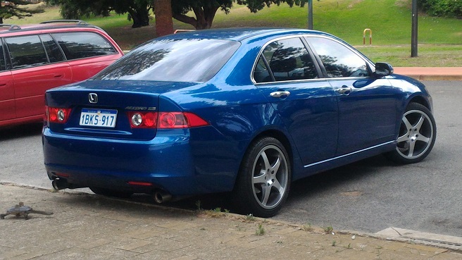

just thought id post a pic of my accord CL9 with some 18x8 +35 rims i put on. Stock suspension. tyres are 225/40/18
Came up better than I thought on stock suspension. Sits a little higher than ideal but i expected it to look higher and 'uncomfortable'. Also doesnt rub at all and did not need any guard work.
The only point i have is that if i could have i would have chosen +45ish wheel offset. As they are with +35 the rears sit dead flush with the arches at 0 camber (all good) but the fronts sit 1cm out of the guards and im not a fan of that look. Its not too bad but really the fronts are what would like the +45 offset.
