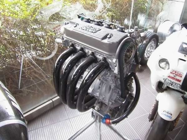

Just letting ppl know, Mugen did experiment on the early d-series, and did race em in the SSCA categories, so proof d-series has had some race pedigree lol
http://www.modified.com/features/070.../photo_03.html
http://i6.photobucket.com/albums/y24...ugen_d16a6.jpg
