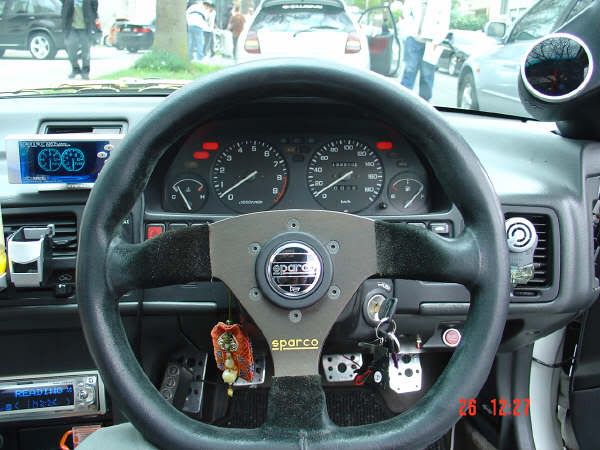

me old one
http://i37.photobucket.com/albums/e6...A9interior.jpg
