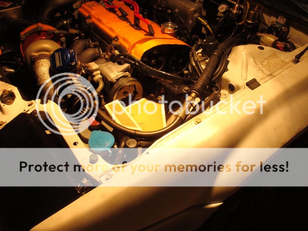

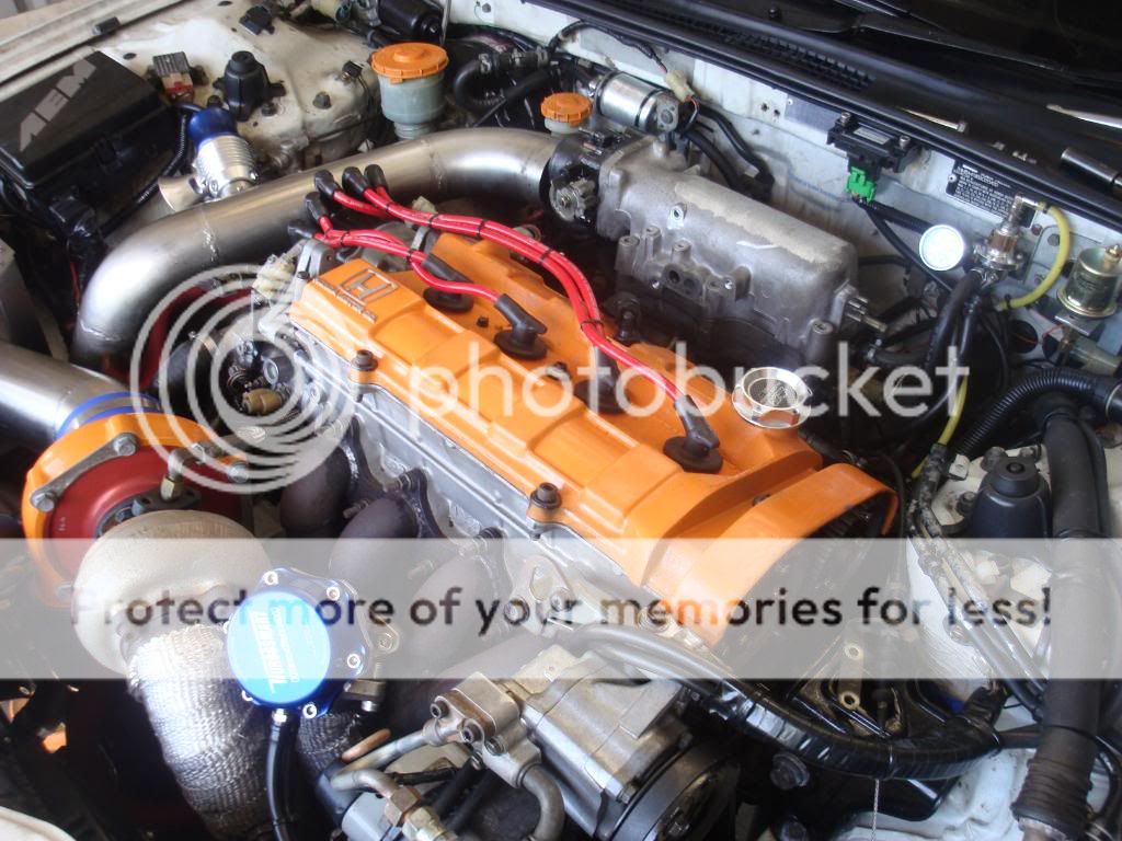

I'm using a 38mm Wastegate too, 11psi spring.
Hopefully it holds up, but it should be fine.. Guess i best play close attention to the Boost Gauge when the time comes, and make sure i'm not getting any uncontrolled Boost at high RPM!

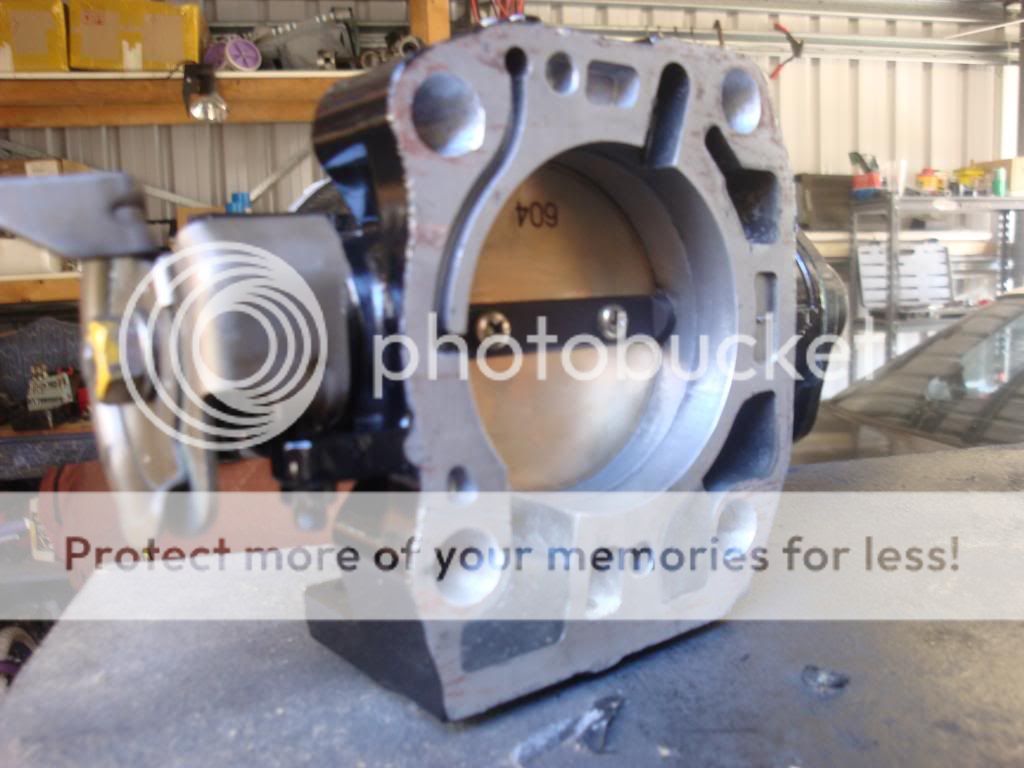

880cc, big! I've opted for 750's.. Seen RC's flow charts for various sizes and 750s seem to retain a good flow at idle.. Whereas any larger start to get patchy, i need this to act like a normal car hehe.
