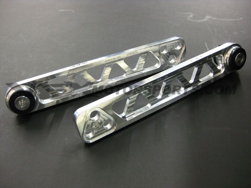

r lca....different shock mounting gap, different bolt pattern on the trailing arm to the lca, different bushings.
