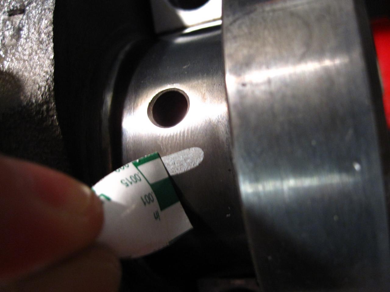

btw does anyone here ever measure bearing crush when they did b20 build?
how did you do it lol.
With our special rotational tires, it will allow you to drive very fast. - JK Tyre
it's called Plastigauge and is very easy (and somewhat accurate) to use...
Attachment 25078
Install the bearings, then torque down the cap to spec. Then undo the bolt on one side, leaving the other torqued. The cap will rise on the side you released. Use a feeler gauge to measure the gap between the bottom of the raised side of the cap and the other mating surface. According to a book I have, it should measure between 0.075 and 0.152 mm.
More info here: http://books.google.com.au/books?id=...page&q&f=false
Never done it myself though.
thanks rayle
yea read that, doesnt that kinda contradict with the whole point of criss cross torque pattern though?
just wondering if bearing crush will stay the same after it has been used for say 10,000kms
or reusing old bearing if its still in good condition.
wouldnt want bearing thats still in good nick but gonna end up spinning
If you're just checking the bearing crush, I don't think it really matters about the correct torquing sequence over all of the main caps (but you should still do the incremental torquing of 25 Nm then up to 76 Nm). In the service manual, it only talks about the correct sequence when doing the final install of the main caps, and not when doing main bearing clearances. You should be able to do the bearing crush procedure one bearing at a time with no issues.
I'm not sure about whether the bearing crush will remain the same though. I wouldn't think it would change significantly over time or due to use, since then you'd have a higher chance of spinning a bearing later on, and I like to think that the engineers who design the bearings know what they're doing.
Since the actual force holding the bearing in place is directly related to the circumference of the bearing, I don't really think that the length would change significantly.
Honestly, I think you'd be fine to reuse the bearing if all of the measurements come out within spec, and there's absolutely no damage on them, but there's a helluva lot of people who won't reuse a bearing (including many who know far more than me).
