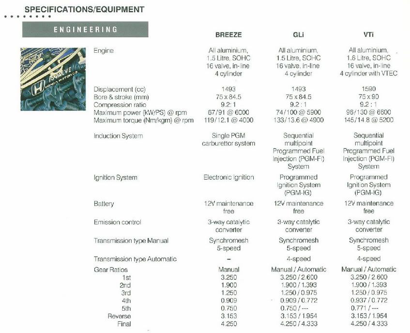

the gear ratio of the eg vti is extra long....especially the third gear...
any d series gearbox could fit but with a shorter gear ratio?
you don't know what you are talking about, the AUDM EG breeze, Gli and VTi all had the same gear ratios for 1st, 2nd, and 3rd. The VTi box has a shorter 4th and 5th gear
http://i225.photobucket.com/albums/d...es/EG-gear.jpg
