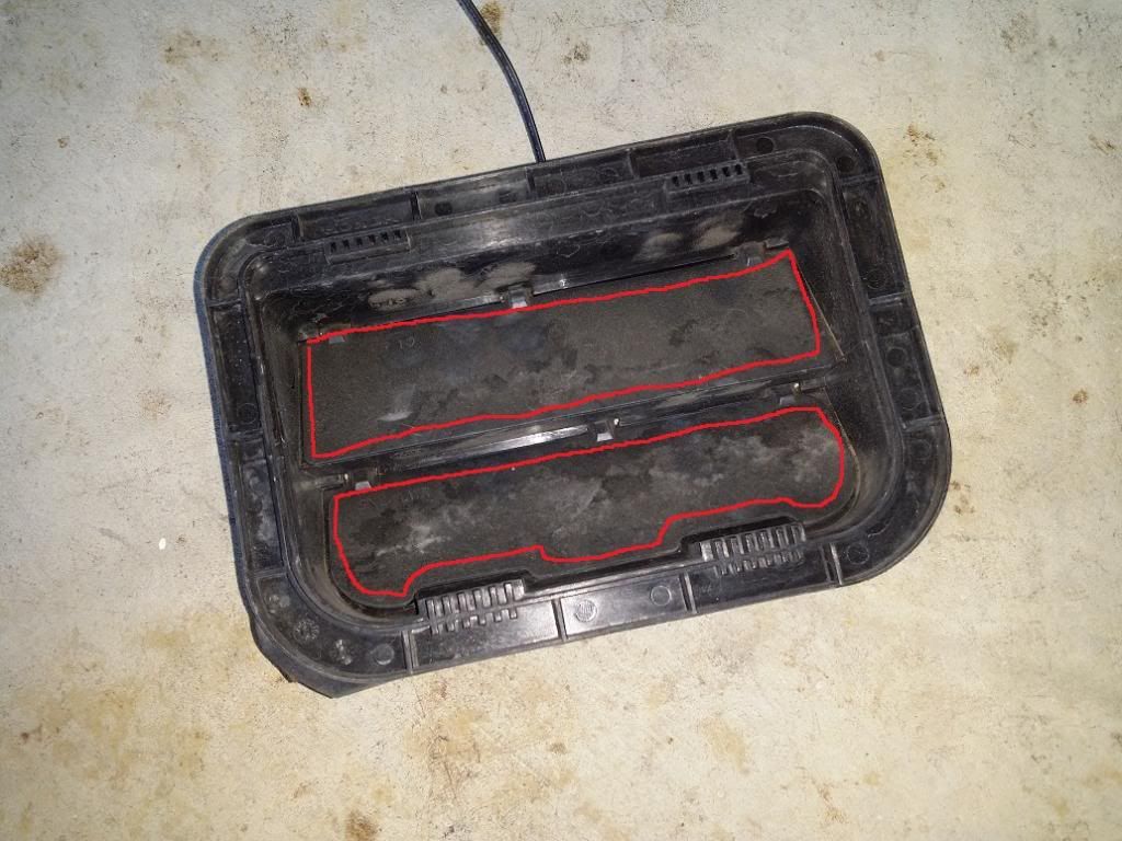

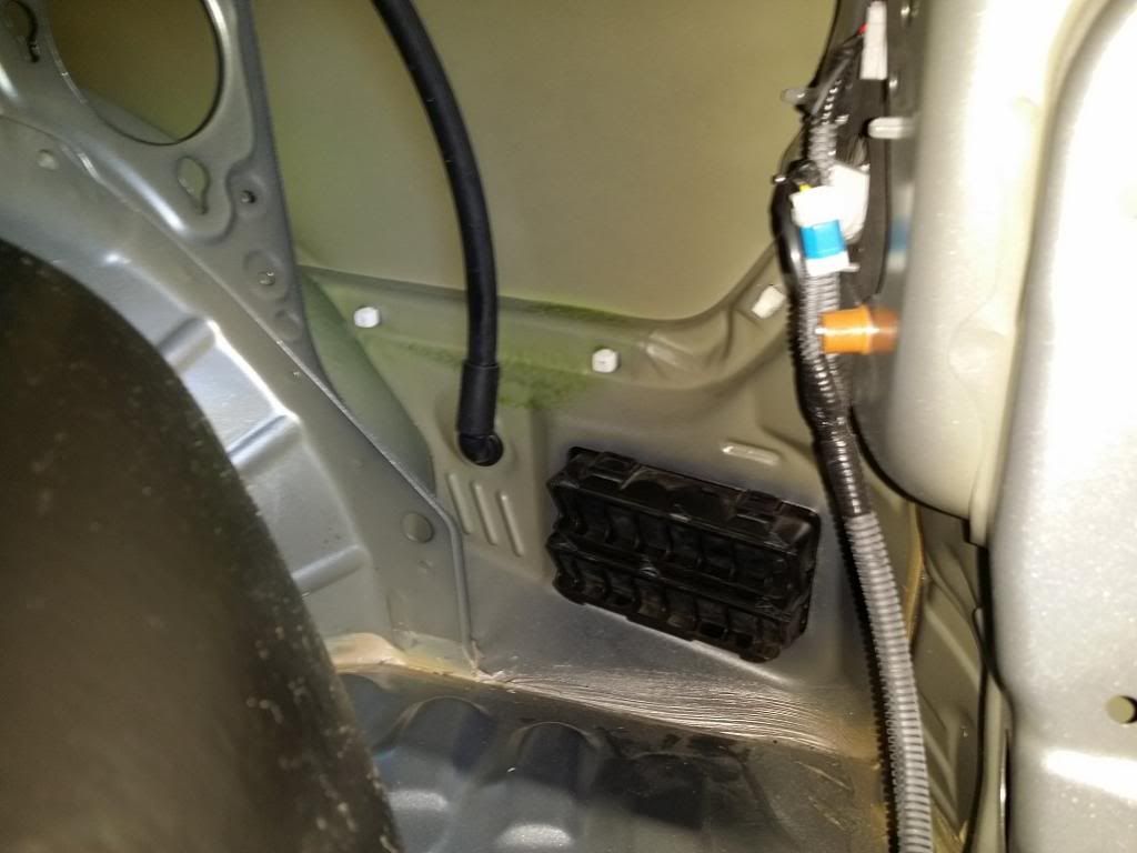

Few posts back I wrote about a rattle that was doing my nuts in. Finally fixed.
It was the trunk air vent. All I did was spent $6 at bunnings for some felt tape. This tape is light and thin like wrapping paper. So it can still flap :)
http://www.bunnings.com.au/felt-adhe...13408_p3970145
Cut the tape to size and stick to both sides of the flapper. There are 4 in total (2 for each side).
Extremely easy to do and now the vibration is gone. I only have dynamats on my front doors and rear shelf. None in the boot lid or trunk.

Hope this helps those with this problem. You can check if you have this problem by playing a high bass song and stand outside on the 2 rear corners of your car (all doors closed)
