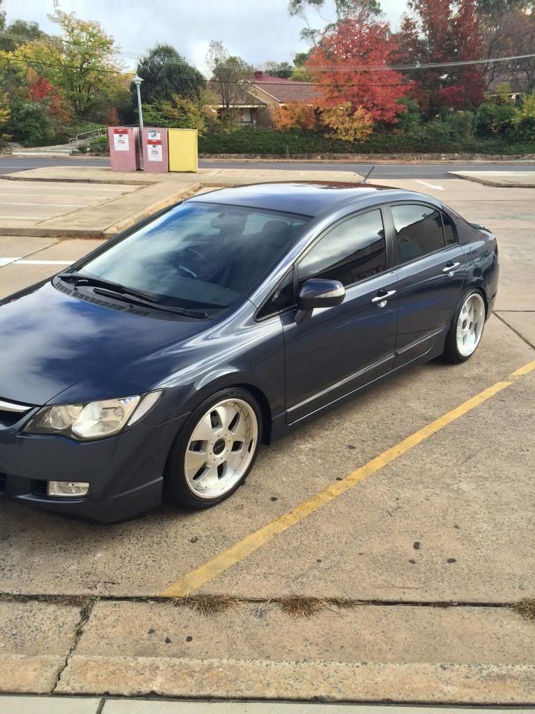

18x8 18x9 rolled and plastic pulled off. bumper tab and fuel cell thing cut. natural camber. i have zero issues with the height of the car (apart from it being 4x4) canberra roads are smoth as baby jesus's bum.
edit - i thought it was a general question to everyone... not just honda_FD whoops. carry on.
