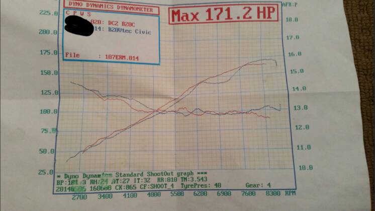

Hey guys.
I've built a b20
84mm rs machine pistons
P72 head
brian crower stage2 na cams
double valve springs
1mm os valves
With 421 headers 2.25" exhaust
and dual runner maifold 3" intake it made 165whp
I swapped to tri y headers 2.5" exhaust and skunk2 manifold whale penis intake and it made 171whp but made less hp up to about 7k an the extra 7hp abouve 7k to 8600 =(
I've just ported the p72 intake manifold for a 68mm tb and going to swap it.
Was wondering if there is a better cam to better suit my engine.
Should be 12:1. Actual compression was 195psi across all 4
Umm I dont remember.. probably cold and dry.
P28 S300 v2 ecu tuned by Rob Novak at my old work, CPWS in jimboomba. He does tuning 999 and definition? Motorsport as well.
So do you guys think all these numbers are half decent? Would a different set of cams give me some better gains?
Hmm tbh I would have thought those cams would be sufficient. By P72 manifold you mean vtir dual runner yeah?
Maybe consider swapping it out for a single runner IM to reduce restriction. Ask your tuner to play around with the cam timing if it has adjustable gears. Getting the timing right can make a massive difference with some cam applications.
Yea dual runner manifold.
I did get a skunk2 pro intake and like I said it loses heaps down low. Attachment 27237
I ran a few different cam profiles thru Engine Analyzer virtual dyno (awesome program) and skunk2 tuner2 had a better power curve then the brian crower cams.
On that dyno chart the red is the dual runner intake and the blue is the skunk2 intake.
Na new tune for new intake and exhaust.
