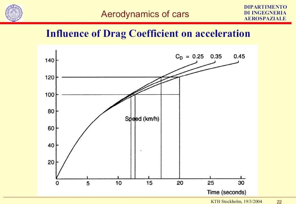

if you can get the summary/point of those articles, all give you the same conclusion : undercarriage/undertray/belly pan cover will give you more aero to reduce drag.
by reducing the drag (with better aero), it might help your perfomance (regardless what is the car or small/large impact), but by the science, it will

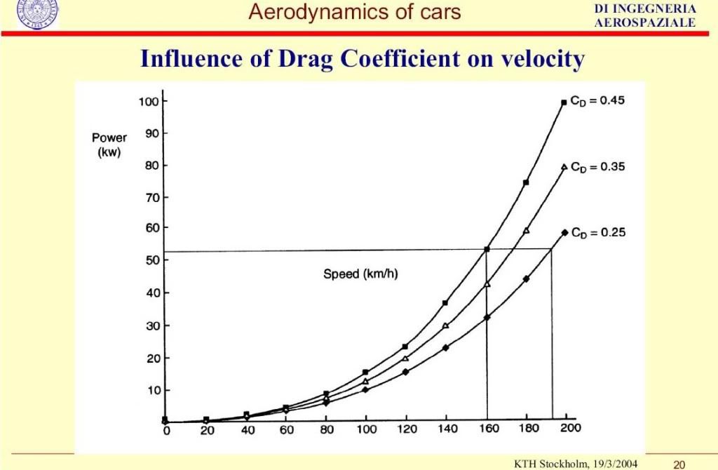

let we start with your 1st point : the Fuel consp (FC), the scientific result, clearly give us some correlation, regardless what is your car, regardless small/big impact
http://i171.photobucket.com/albums/u...sperdmx/cd.jpg
if you can read the chart : cd 0.25 : to reach 100kmh need 10kw power
cd 0.35 : need 12-13 kw power. means the lower cd, lower power needed, and as result less FC.

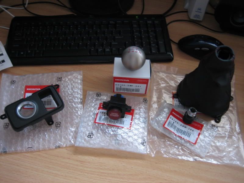

Finally got these today from japan!
Does anyone know where i can buy the cables to get the start button up and running?
The DIY diagrams i have seen around the net arent that clear on what to do.. can someone help?? :) thanks!
