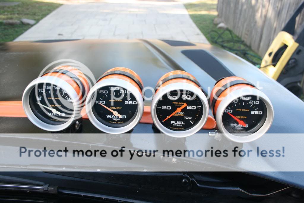

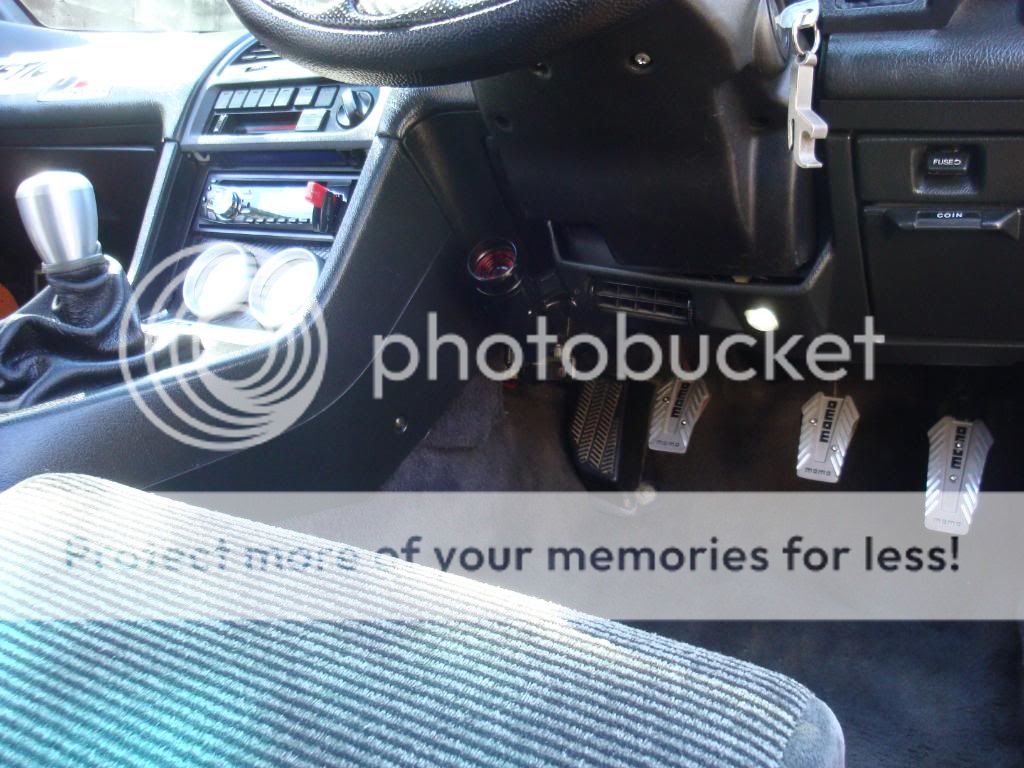

knock warning light ( had a spare shift light and installed a red LED bulb with 510 resister )
http://i431.photobucket.com/albums/q...z/DSC03603.jpg
http://i431.photobucket.com/albums/q...z/DSC03604.jpg

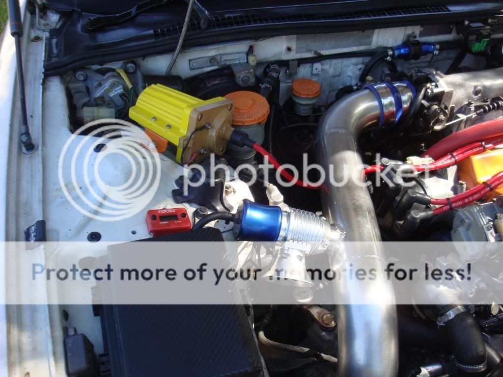

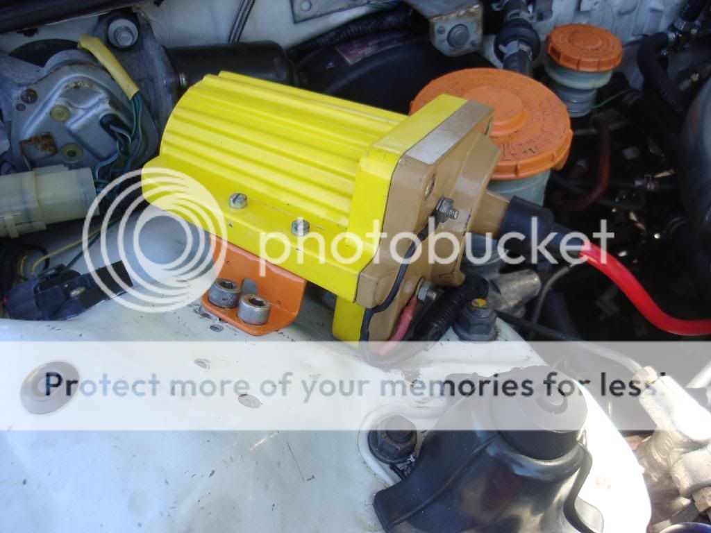

installed the big excel race coil all thats needed is a 6AL cdi of some type and cold plugs
http://i431.photobucket.com/albums/q...z/DSC03605.jpg
http://i431.photobucket.com/albums/q...z/DSC03606.jpg
http://i431.photobucket.com/albums/q...z/DSC03607.jpg
http://i431.photobucket.com/albums/q...z/DSC03608.jpg

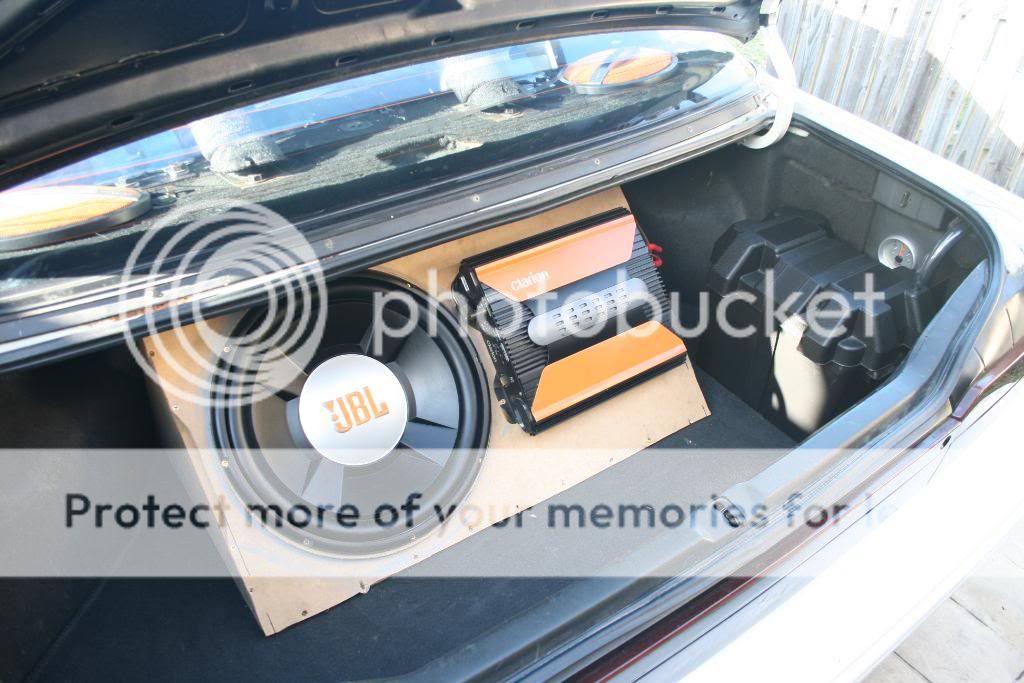

and some random pics because i love the look of it
http://i431.photobucket.com/albums/q...z/DSC03609.jpg
http://i431.photobucket.com/albums/q...z/DSC03610.jpg
http://i431.photobucket.com/albums/q...z/DSC03611.jpg
http://i431.photobucket.com/albums/q...z/DSC03612.jpg

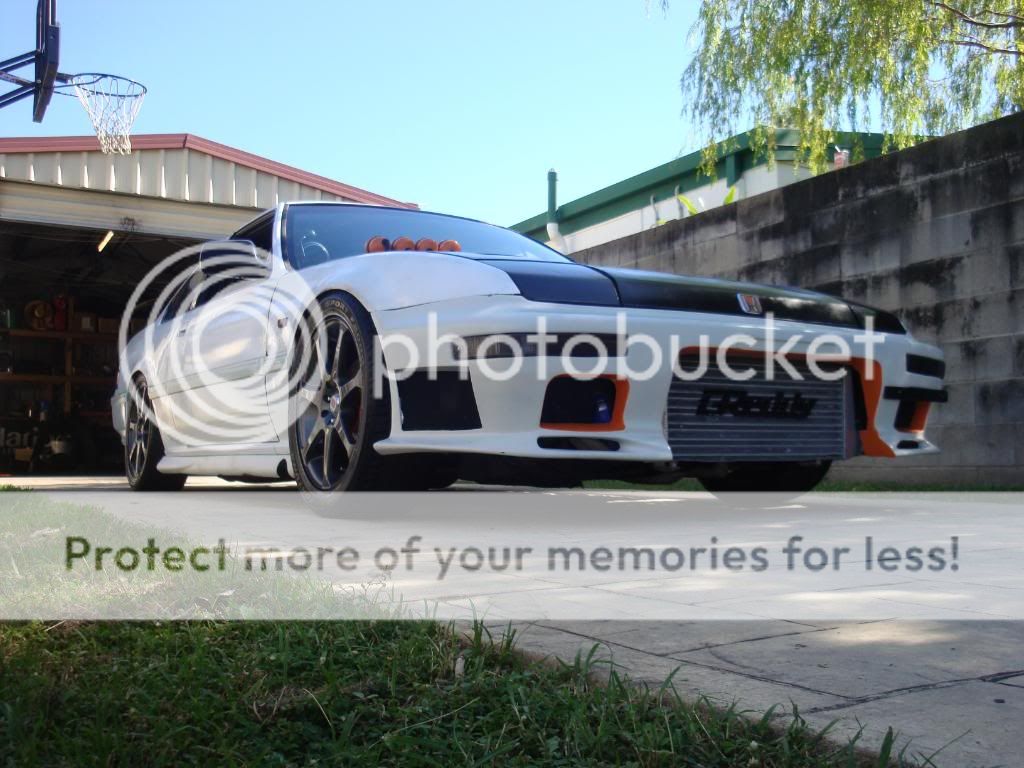

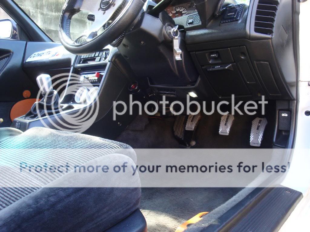

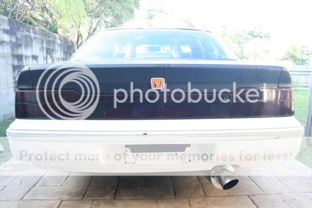

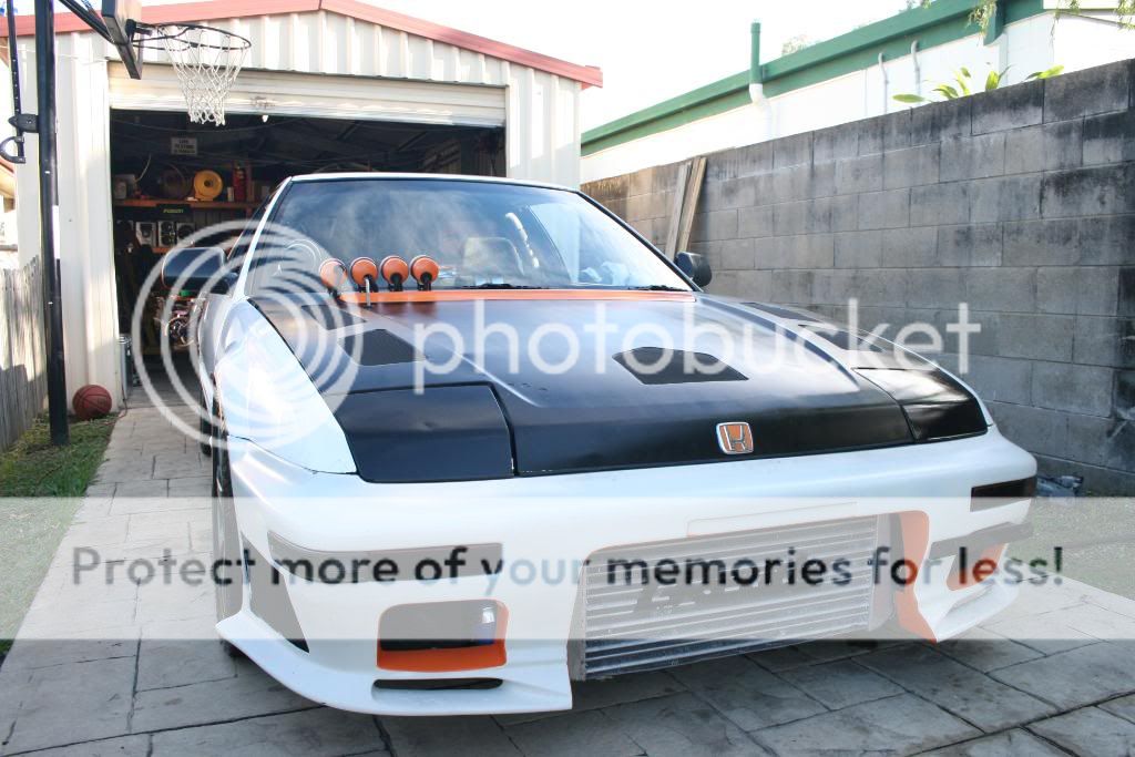

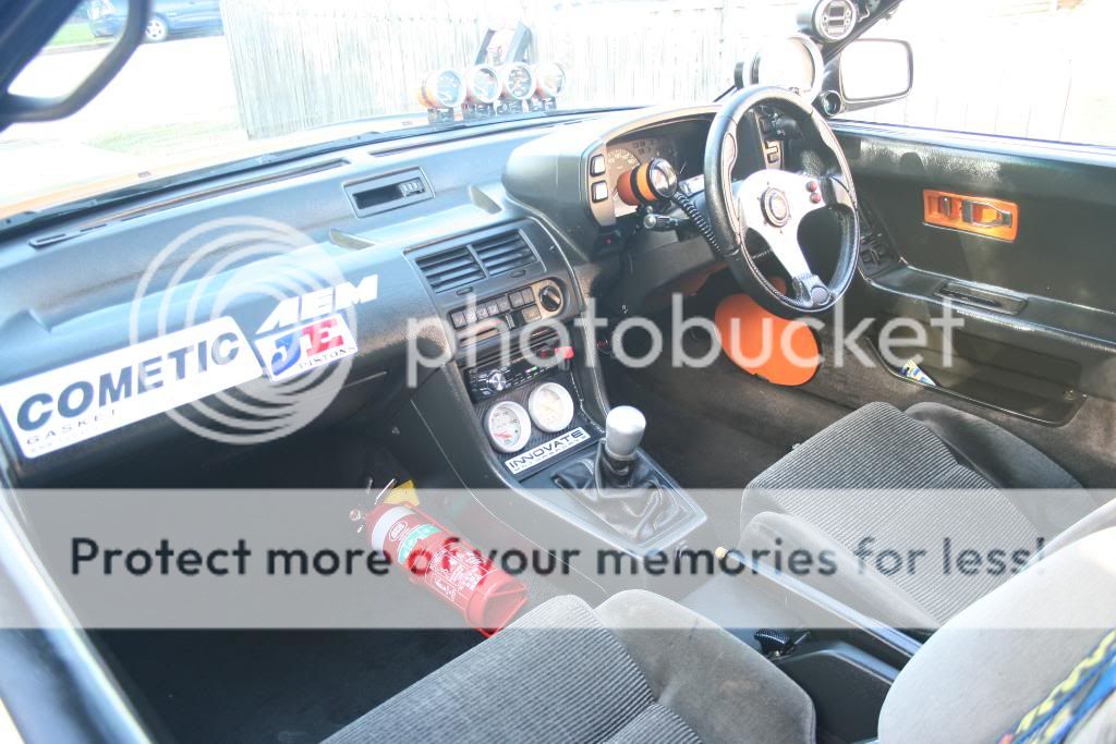

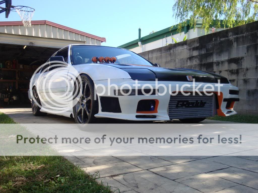

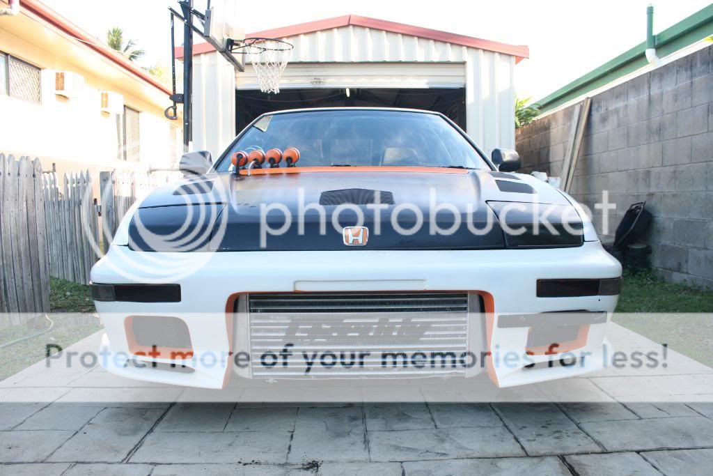

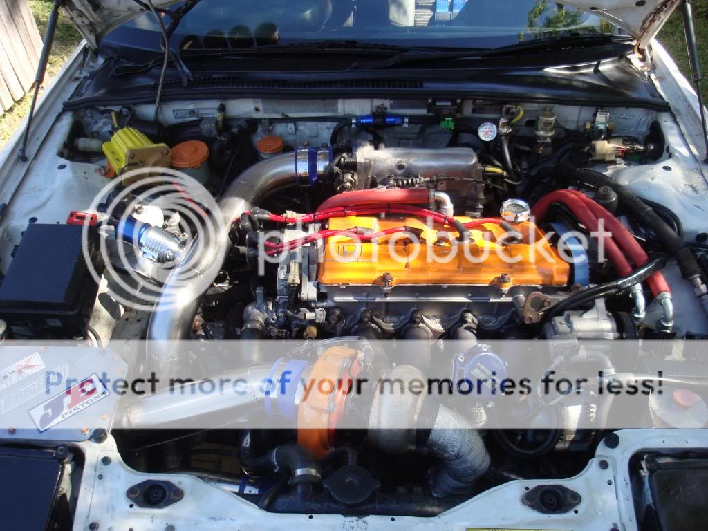

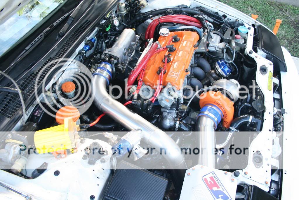

ok bit of a update lude is ready for roadworthy and rego and booked in on the 8/6/12 , gave it a bath , degrease underneath and engine bay and a clean up inside . took some pic's for the mechanic who is going to hopefully pass it for me and show him tomorrow and see if he's happy with the way it stands .
http://i431.photobucket.com/albums/q...z/IMG_9715.jpg
http://i431.photobucket.com/albums/q...z/IMG_9748.jpg
http://i431.photobucket.com/albums/q...z/IMG_9749.jpg
http://i431.photobucket.com/albums/q...z/IMG_9752.jpg
http://i431.photobucket.com/albums/q...z/IMG_9717.jpg
http://i431.photobucket.com/albums/q...z/IMG_9734.jpg
http://i431.photobucket.com/albums/q...z/IMG_9721.jpg
http://i431.photobucket.com/albums/q...z/IMG_9722.jpg
http://i431.photobucket.com/albums/q...z/IMG_9732.jpg
http://i431.photobucket.com/albums/q...z/IMG_9733.jpg
http://i431.photobucket.com/albums/q...z/IMG_9728.jpg
http://i431.photobucket.com/albums/q...z/IMG_9729.jpg
http://i431.photobucket.com/albums/q...z/IMG_9730.jpg
http://i431.photobucket.com/albums/q...z/IMG_9736.jpg
http://i431.photobucket.com/albums/q...z/IMG_9737.jpg
http://i431.photobucket.com/albums/q...z/IMG_9738.jpg
http://i431.photobucket.com/albums/q...z/IMG_9745.jpg
http://i431.photobucket.com/albums/q...z/IMG_9746.jpg
http://i431.photobucket.com/albums/q...z/IMG_9747.jpg

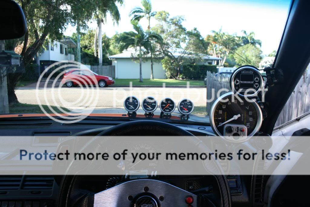

Can u get open gauges road-worthy?
Open intercooler is road worthy?
If it was in wa, police will shoot you down
this is why i live in QLD
