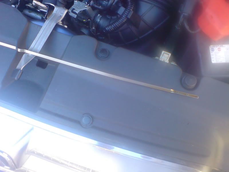

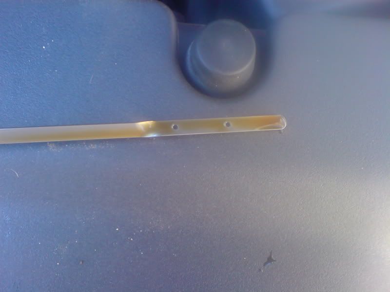

which one is the full indicator. the dots?
http://i77.photobucket.com/albums/j7...0/DSC00164.jpg
http://i77.photobucket.com/albums/j7...0/DSC00163.jpg
Full is the dot to the left of photo.
*edit* wipe the stick with a rag. Put the dipstick back in, pull it out and see where the level is.
The dot on the left is the maximum. When you check oil level, pull the dip stick out, wipe it with clean tissue or rag, then put the stick back in and pull out again. That way you will get a clear reading, not like the one in your pic where there is oil all along the stick. It is alright to be slightly higher than the maximum dot. I usually put about 0.5cm over the top dot.
The dot on the right is the minimum. Between the minimum and maximum dots is roughly 1 litre.
