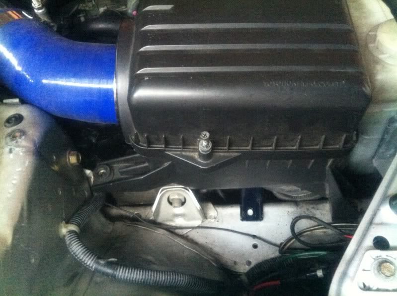

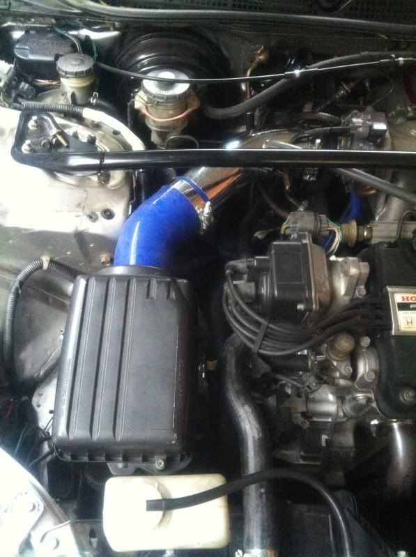

I dunno what to call this but the car was like this when i got it and still is like this
http://i783.photobucket.com/albums/y...n/IMG_1229.jpg
I dunno if a proper CAI will be worth it as im doing a engine swap somewhere in the future next year. It doesn't give more kw/hp but better response right? i maybe actually enjoy that than . . . hmmm

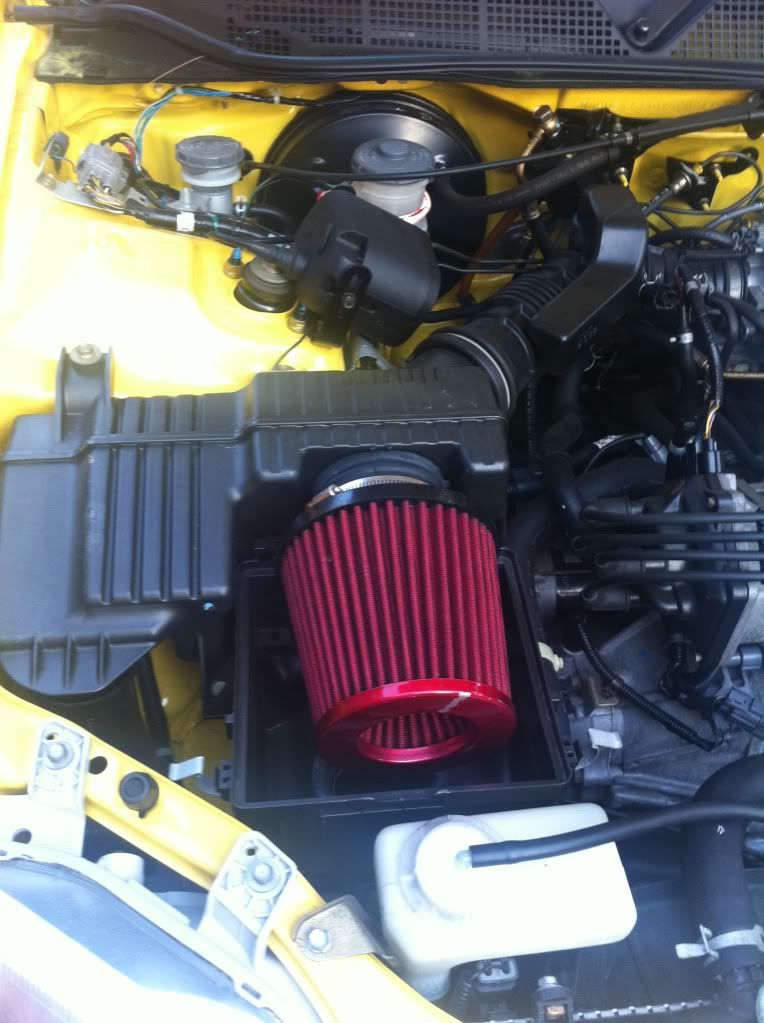

If i were you, i would try and retro fit the cover back on if the filter fits inside.
then put a cold air feed below the box where the old resinator used to fit.
i thought about this setup, but cbf playing round it incase i get defected i still have the oem box.
so instead this is what i did.
DC2 Box with a Comptech Filter with Cold Air Feed

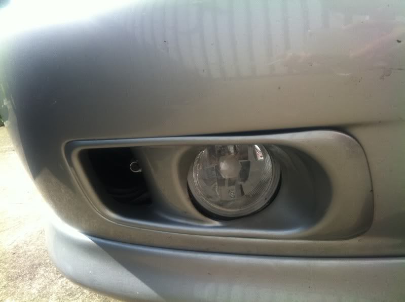

Cold Air Feed - next to the Foggies.
http://i78.photobucket.com/albums/j1...oldAirFeed.jpg
By doing this, i still got to maintain a OEM look (well apart from the 3inch intake arm and the blue 45deg coupler.
but works great and i feel the barrp barrp barrpp barrppppp
"VTEC just kicked in YOOO!!
