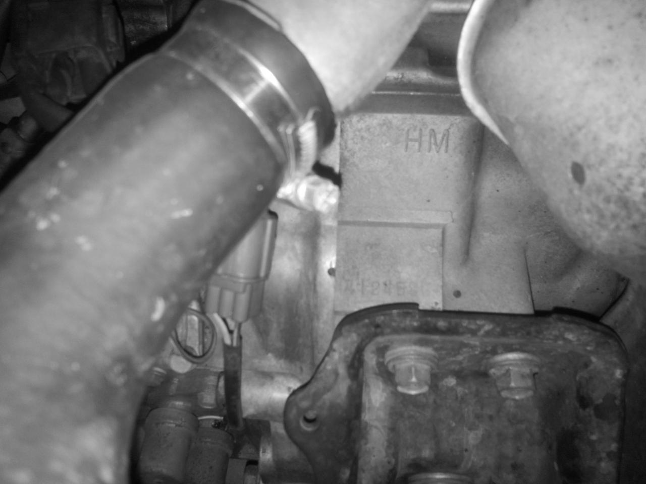

Couldn't find the engine block stamp here is a pic
Attachment 21656
Attachment 21656
didn't realise it was from an odyssey...
what does it say under the rad hose in that photo?
Odyssey lol
It said under the radiator hose:
HM
F22B
(some numbers) 42145?
Here is a black and white image
Attachment 21657

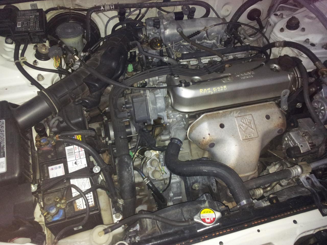

Can having this Odyssey engine cause any complications?
In particular I've been shopping around for the following parts:
- manifold intake gasket
- rear exhaust (has a hole in it)
- alternator belt
- sump gasket
- engine mounts
- timing belt/balance shaft belt
Have been asked the question "is this for a F22B3 or F22B1" should I be telling them I have an Odyssey F22B engine?

Regarding ur PM question u sent me - no it won't have an issue if you have an odyssey engine, just search for the right engine code. It may vary between years, just make sure u double check with the parts manufacturer
where do i find the engine code?
It looks like an F22B3.

JDM engines were stamped only as F22B.
Tell them the engine is an F22B RA1 out of an Odyssey (seems like 95-97 era) and they should be able to find it.
The RA1 that is written on your new swapped engine refers to the chassis code of the Odyssey it came out of.
The Accord and Odyssey shared a common platform and a lot of compatible mechanicals
Thanks guys. The suppliers confirmed gaskets for Odyssey and Accord F22B3 are the same.
