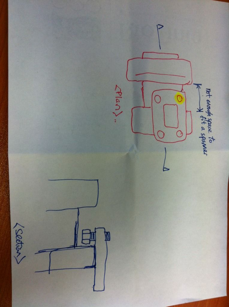

for those who keep saying "get extension and reach from bottom, once again, there is a turbo under the bolts.
i sketch whats like, cant take more photos now because i am at work.

dw abt the bracket

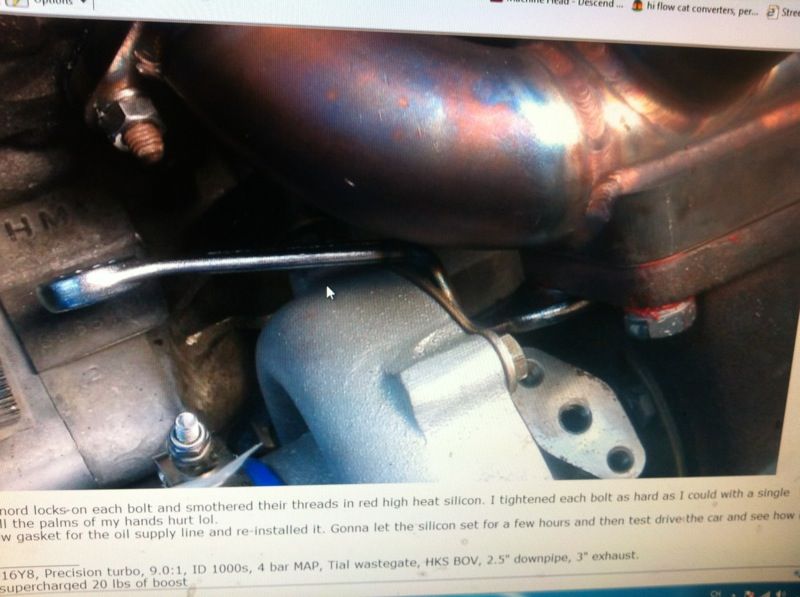

finally found a solution on honda tech.
this guy has the same problem.

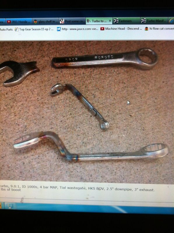

http://i1168.photobucket.com/albums/...071/photo1.jpg
http://i1168.photobucket.com/albums/...071/photo2.jpg
now just need to get BBF's dad to heat it up and bend it.

wth, take a photo of your screen?
why not screenshot?
LOL screenception
