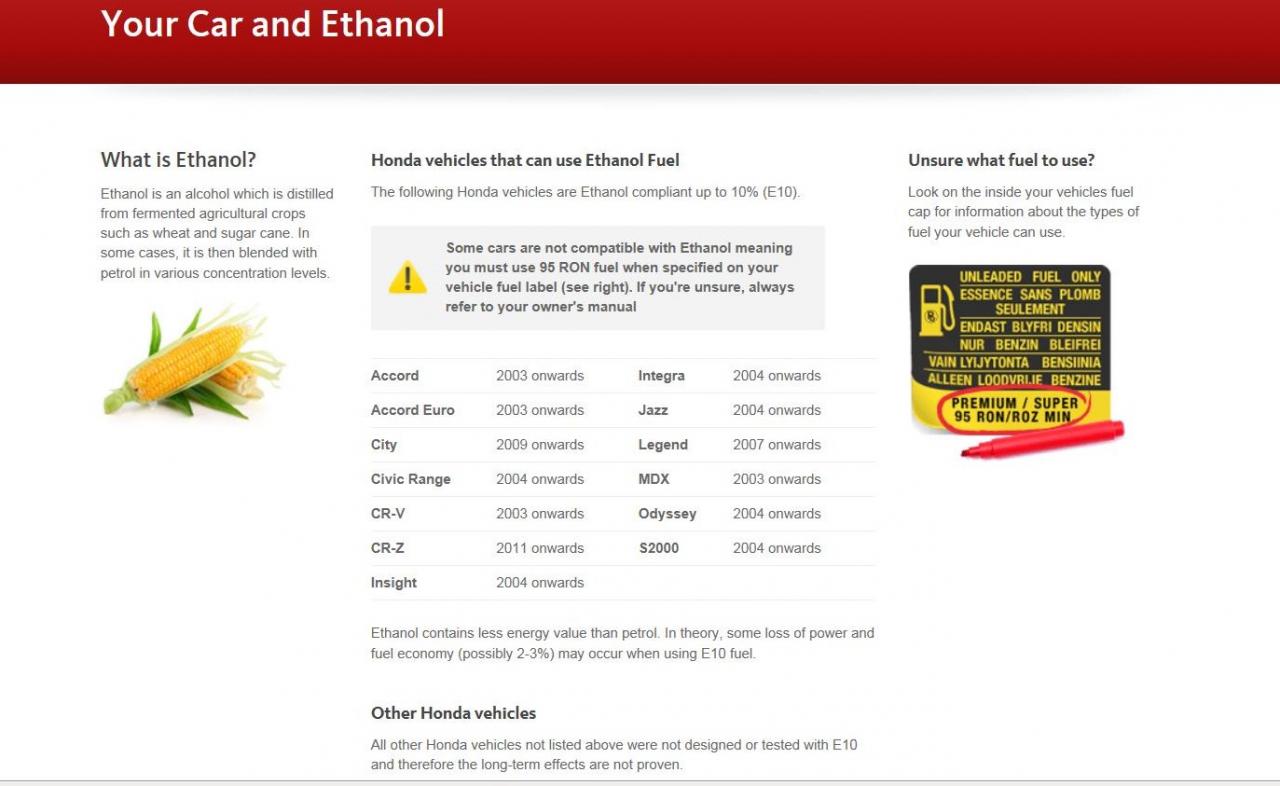

Attachment 24360
some handy info from Hondaone
The fuel needs to be be E10 AND at least 95 Octane to be used.
Not any plain old E10 is usable.
Most people don't realise that
