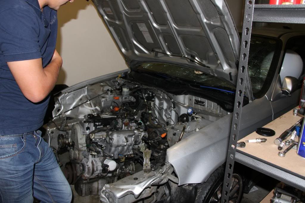

what a C*&$t of a job it was but the car finally gave way and we got the engine and box out those hub nuts are not good glad everyone else uses split pins. we had guns on it 600m breaker bars they were not moving.

still haven't got rid of shell ran out of time had so much F@^#^*&#@(#@@#@((#@#@#@#@ with the hub nuts that i finished at about 5 so i have to hang onto it for another week or so. so if u need anything i haven't already taken off or destroyed as you can see a hammer was used to kill frustration on about everything. but there is heaps of good stuff still left on the shell so the suspension and so on is still there. most interior panels are there but dirty and all electrics worked the front bar has fog lights in it and there are so much more.

After busting my 1/2" drive breaker bar, I graduated to this
http://i898.photobucket.com/albums/a...r3part2010.jpg
3/4" drive with air tool socket and a metre or so of pipe over that which in the case of this particular nut required standing on and jumping up and down to crack it. (other helpful hint) always do it with wheel on ground and handbrake fully applied.
