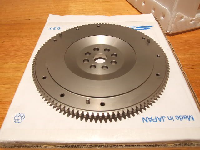

Hey matt,
basically, your car will feel more on/off (the only real way i know how to describe it) when it comes to clutch engagement in particualr. The revs dropping and rising really quickly is most pronounced in first gear. I found that with a quick shift it was easier to chirp into 2nd and (to a lesser extent) 3rd.
Personally i found the car much easier to stall with a hd clutch and lightweight flywheel. A previous euro owner (with a stock clutch and flywheel) recently drove my car and commented how on/off more easily stalled it was. I find i need to give it more revs to take off smoothly without shuddering. Just below 2krpm sees a good clean take off normally.
another unexpected affect i noticed is that in the higher gears the engine seems to pick up from lower speeds. in 5th gear in the euro i can get the car moving farily comfortably from 60km/h (less than 2k rpm or so from memory)
