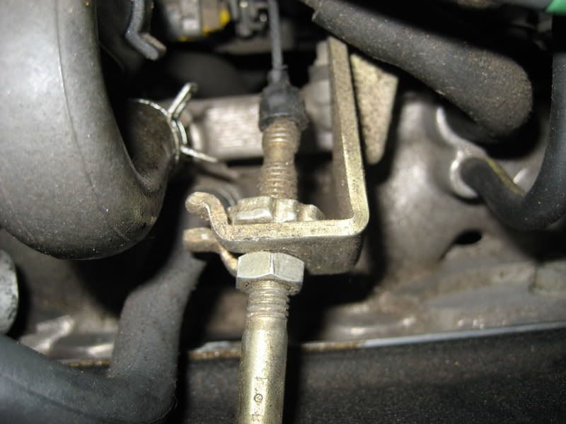

the cable has a thread, near the thottle, and is tightened and kinda locked onto a bracket with 2 nuts, loosen the nuts and move the cable, and lock it into place.

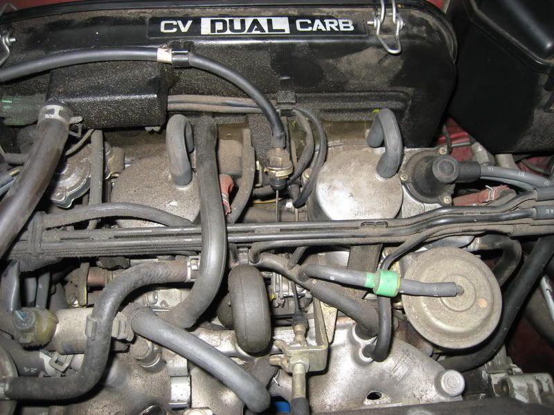

if you get me a engine bay pic of it, i'll show you.

easy to do.
take you a few minutes
all you do, is loosen the nuts, move the cable so it tightens a bit, then tighten the nuts so the cable stays in place.
and adjust to how you think it right, so it might take a few goes.

Hi - here are some pics - if someone can tell me what I am adjusting and where that would be appreciated.

This seems like the right spot as it leads to the auto box ---so I losen the nuts. What is the best way to tighten the cable - just pull on it at top of picture then tigten the nuts?

All sorted! Thanks for your help guys I figured it out. Gears change up to 5000rpm in 1st and 6000rpm in 2nd gear now. Close to how it should be I think for an automatic.
If I make it any tighter it idles too high so this is a good comrpomise for a 16 year old car. Car kicks along nicely for a little 4 cylinder - I think the 900kg kerb weight makes all the difference though.
