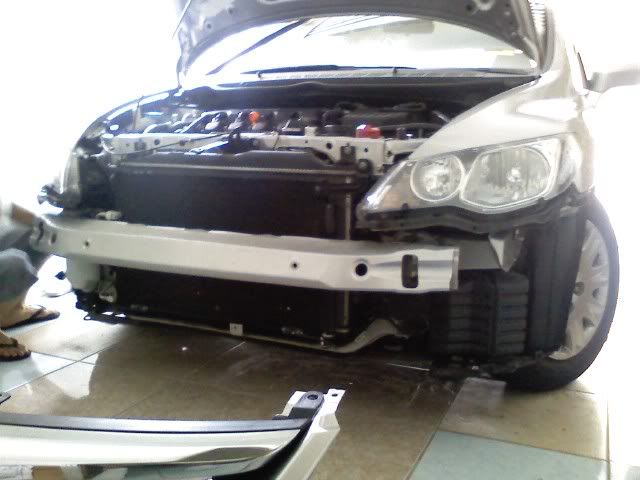

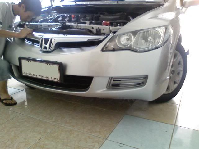

pics of my DIY
that's my friend that helped me in this 1st pic btw :p
http://i167.photobucket.com/albums/u...-09_110101.jpg
http://i167.photobucket.com/albums/u...01-09_1107.jpg
and after.
http://i167.photobucket.com/albums/u...IMG_1692-1.jpg
note, that i dont have any pics with them actually turned on, because we got confused with the wiring instructions then it got late and we had other stuff to do lol :p
will be getting them up and running asap tho :D
