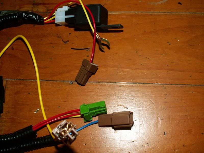

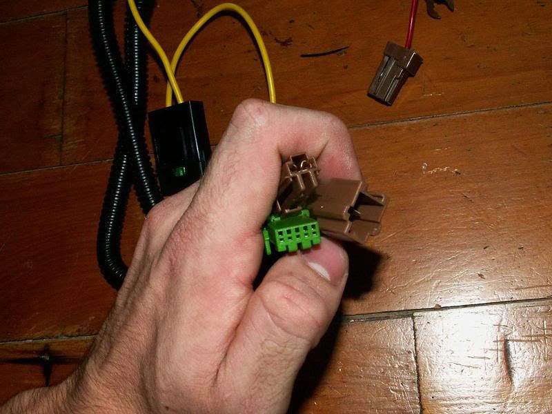

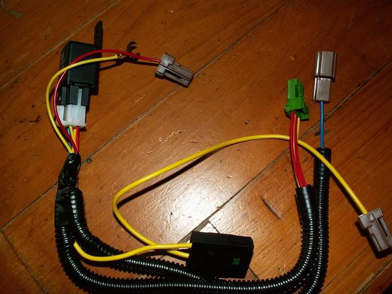

Here are the pics of the connectors that i was given.

ok, so do all the plugs on the foglight loom all 'fit into' each other? minus the wire from the fuselink , one from the fog loom (i think) and one from the switch.... cant remember exactly...
there should be two looms. one is for the fogs. and then another loom with the relay, etc which then connects to the fogs. correct?
better yet, take a picture of the loom and all loose plugs and sockets and i'll see what i can do from melbourne in front of my pc to perhaps guide u a bit.

thanks bud, thats the ones i was given and NONE of the 3 or 4 in the dash would fit into them.

So the ones which are circled, do not physically plug into anything honda. i am very very certain (99%) these need +tive power. The yellow one best to run straight to battery.
The small red one best to splice an interior power cable - i highly recommend the cigarette socket power. This effectively powers the switch light. I found the fogs did not turn on if this was not powered.
You will need to make a wire up using a spade connector (i think - the flat ones), shove it in the female spade inside this brown socket and then run that into postive power..
there should also be another ground wire from the fogs themselves... but cant see here. give that a try.
BEFORE you go and put cables all over the car, do a trial install. so ground what needs to be grounded and power what needs to be powered. and see if the fogs work.

So cut the ciggy power and hook it up to this?

Where are you locating this loom? either way, you wil need to run wires through the firewall.
You will need to simply get a spade male terminal (with a wire to the battery) and shove it into the female terminal (inside the brown socket).
Don't cut it. Just splice it. So make a break in the plastic shield on the wire, so u can get to the metal wires underneath, and then tap into it.
