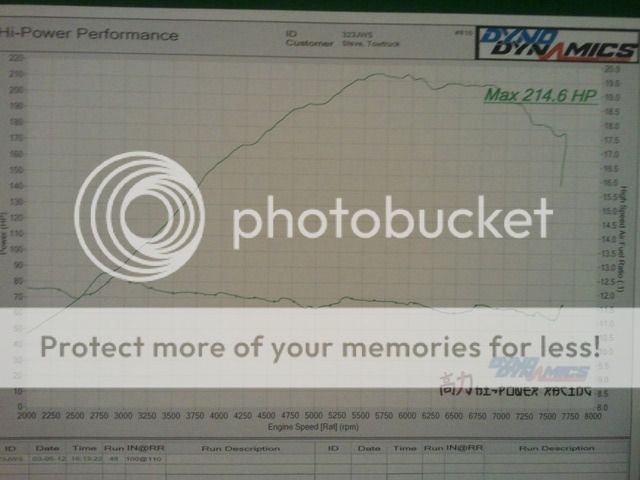

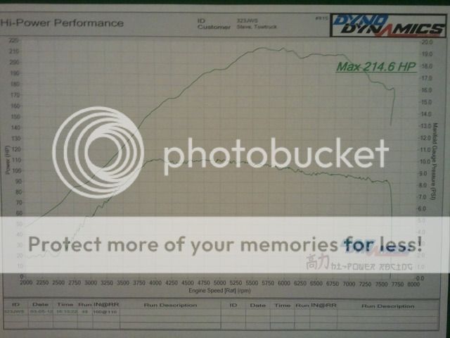

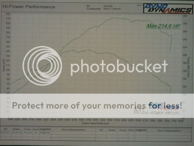

one thing i did with mine was,
got a tune from a guy from the usa.
i would data log a bunch of runs down the highway at different boost levels and he would make adjustments then i would go out again after i upload the changes then send him another datalog.
worked out well and couldnt have been done without a wideband :)
