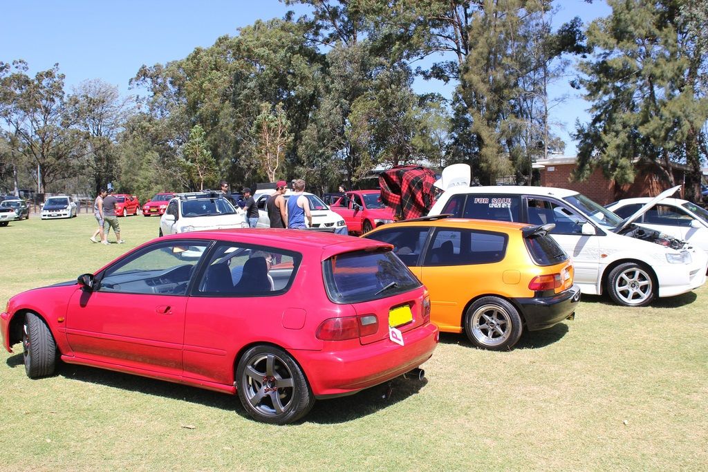

Throw back Thursday.
From 2013 JMDST Spring Meet.
http://i891.photobucket.com/albums/a...0c36d068_b.jpg
I had to rub a A-LOT of wax on the sh!t paint to make it look that nice, or maybe it's just my mates SLR camera. You can see that it's pink-ish.
I remember I had got new Kuhmo KU31s earlier that week. To this day, only done 4** kms on the new rubber.
Stay tuned for the next throw back photo. Hehe..
